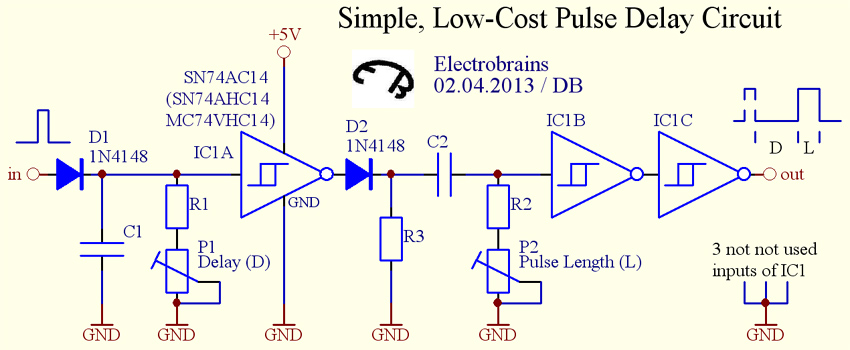

You could probably use this simple, cheap circuit.
It shows adjustable delay and pulse length, which of course you could fix at whatever value you want.
I have not tested the circuit, so there could be a bug somewhere, but I don't think so.
Your task would be to calculate the RC values. For your super fast application, the capacitors would be low value types (pF).
The Pulse Delay is triggered from the falling edge of the input signal. With some changes, it could be triggered on the rising edge.
The suggested IC(s) should be fast enough.
The diodes too, or you might use Schottky Diodes instead.

Thanks woodchips - the scope has 50 GHz bandwidth. I did consider a delay line from coax cable, although for the desired 5 us delay, I'd need a few hundred m of coax, which is a bit impractical.
Thanks too electrobrains - that's a really helpful circuit and the ability to vary the delay could be very useful.
I assume R1&P1 with C1 set the delay time constant, and R2&P2 with C2 set the duration constant. I've checked out the spec sheets for the IC but don't fully understand the purpose of the schmitt-trigger inverters, especially the two at the circuit output. Are they there to help sharpen-up the pulses after the RC delay?

..I assume R1&P1 with C1 set the delay time constant, and R2&P2 with C2 set the duration constant. I've checked out the spec sheets for the IC but don't fully understand the purpose of the schmitt-trigger inverters, especially the two at the circuit output. Are they there to help sharpen-up the pulses after the RC delay?
The Schmitt-Triggers are needed for quite accurate switching points. They give the necessary hysteresis and as you say, "sharpen-up" the pulses.
Yes, R1&P1 with C1 set the delay and R2&P2 with C2 set the pulse duration.
The third inverter just inverts the signal and gives you the same polarity as the input.
It also adds a small delay (ns).
If that disturbs you, it could be removed and the second inverter could be used as output. Even with the right polarity, if the RC components would be referenced towards +5V.
I prefer using ground as reference and because there are 6 inverters in the package I just added the third one.

I would wonder what effect the propagation delay of the 74HC14 would be on this circuit.
At 5V, the typical propagation delay is 12ns. Added to this, the typical transition time is 6ns.
The pulse you get out of this circuit is not going to look very "square"
The input capacitance of the gate (approx 3.5pF) might also be a problem.
Also, is the 1N4148 able to recover inside of 2ns? (The minimum is 4ns, and the capacitance is 4pF)

Steve, the circuit is 74A... not 74HC. The A versions are faster.
About 1N4148, you are right about the recovery time. That's why I mentioned the Schottky Diode. It could well be that another (HF) diode must be used instead.
What also concerns me a bit is the input impedance. The source of the input signal must be very low impedance to be able to charge the input capacitor (C1) within the pulse width (2ns)!
Maybe the rest of the inverters in the package should be used as input buffers.
