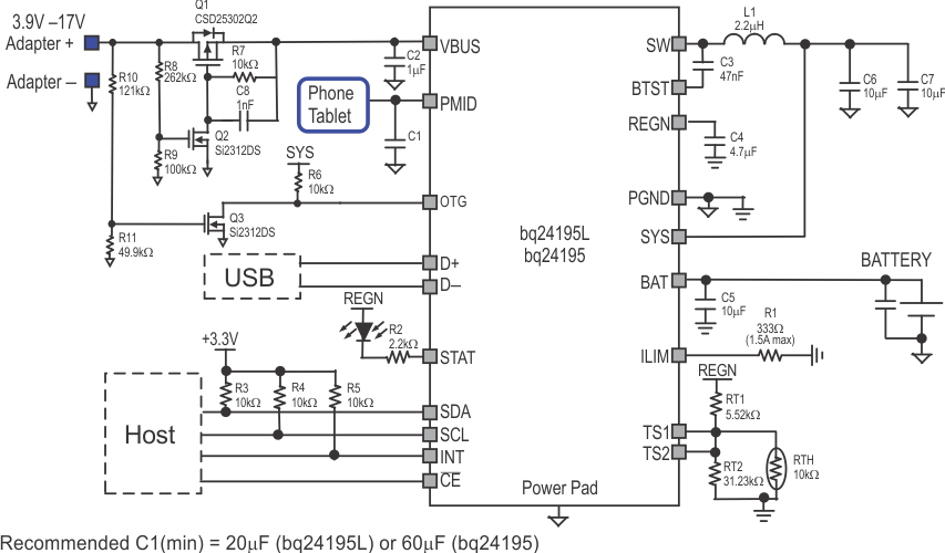

I need to design Li-polymer battery power bank that charge from solar input and output 5V/1A.
I selected this chip and attached image is what they have given as schematic.
I have few questions.
1). is my selection is good?
http://www.ti.com/product/BQ24195/datasheet
Next questions are regarding attached image (schematic )
Q2) . what is host? what is phone tablet ? is that where we connect phone?
Q3). What is power pad means?
