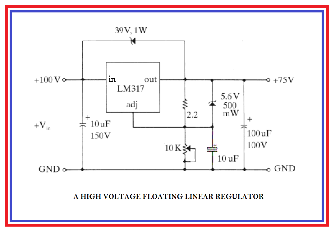

Seeeeeeeeeeenor Javier
. . . . . . .(and thats being heaveeee on the Seeeeeeeeeeeeee)
Try This One
Breadboard it up and . . . . . . . . check it out . . . . . . .
CAVEAT . . . . . breadboarding up this circuitry reveals a need to establish a safe low voltage reliability threshold of ~ 10 VDC . . .so use it for 10VDC, upwards. . . . of DC output voltage.
Also watch current pull . . . as dissipated wattage across the '317 increases rapidly, at ever increasing higher voltage output levels.
In more recent times, when I needed a high voltage regulator . . . BUT . . . . didn't want to take a quantum leap back in neanderthal design technology,by having to use 6L6 or 6080 kluge vacuum tubes.
I would just use this type of circuitry quirk, which permits using the common LM317 for its control element, by the control of the max voltage being available across the LM317 by the shunt zener . . . .voltage limiter.
I have made up to a 250V supply using this methodology . . . .but at those high voltages, naturally, a lower current draw is the norm.Since a mere 100 ma at 250 volts equates to 25 watts of power !
BUT . . . . one could also use the technique of a shunting power transistor across the LM317 in and out to up the devices power capability.
Consult NATIONAL data sheets for the LM317 for more info. . . . . or I think that Tejas Instrumentos. . . . . in being their new Sugar Daddy / Moneybags . . . . has carried them forward into their tech files and application notes.
Errata:
I now see that the adjustable resistor pair for voltage scaling, had the K of 2.2 K omitted, and the variable 10K might have to be scaled up or down a bit, to trim in your voltage adjustment end limits.

@73's de Edd : Your circuit will work for out output voltages down to 61 V ( a bit more considering the accuracy of the zener).
The op required 1.25 V ... 30 V. This is not going to work as the zener will become conducting, overriding the LM317's regulation.

Sir Harald . . . . . .et al . . . .
That circuitry is that which I used to replace an OA3 gas tube regulator.
It "woiks" magnificently . . . . .even with no omnipresent glow..
In the case of the lower thresholds of the lower voltages mentioned, the 39V Zener still protects the LM317, while the other zener transitions into being a 1N4006.
Thasssitttt . . . .

@73's de Edd : I still disagree: At Vin=42 V and Vout=1.25 V, the voltage across the LM317 needs to be 40.75 V. There's no other way this can be achieved with this circuit. At 40.75 V the 39 V zener diode will be conducting, however, whic will lead to a current that increases the output voltage to (42 V -39 V) = 3 V, thereby anihilating the regulation down to 1.25 V.
Or which detail am I missing?

Well I just saw that Sr Javier made it back to the scene and needs a more positive answer.
SO . . . . I pulled a radar IF amplifier strip assembly off my $100 an hour spot on the bench and cobbled up that regulator circuit to evaluate its operation at the very low voltage levels.
Indeed it does start getting dodgy at about 7 V, where its stops having a linear change and starts having a cramped /compressed variance until it stops.
That must relate back to the reason for the 4.7 V zener shown in the initial schematic . . . .to make an abrupt limiting knee on adjustment in the low voltage end of the spectrum.
