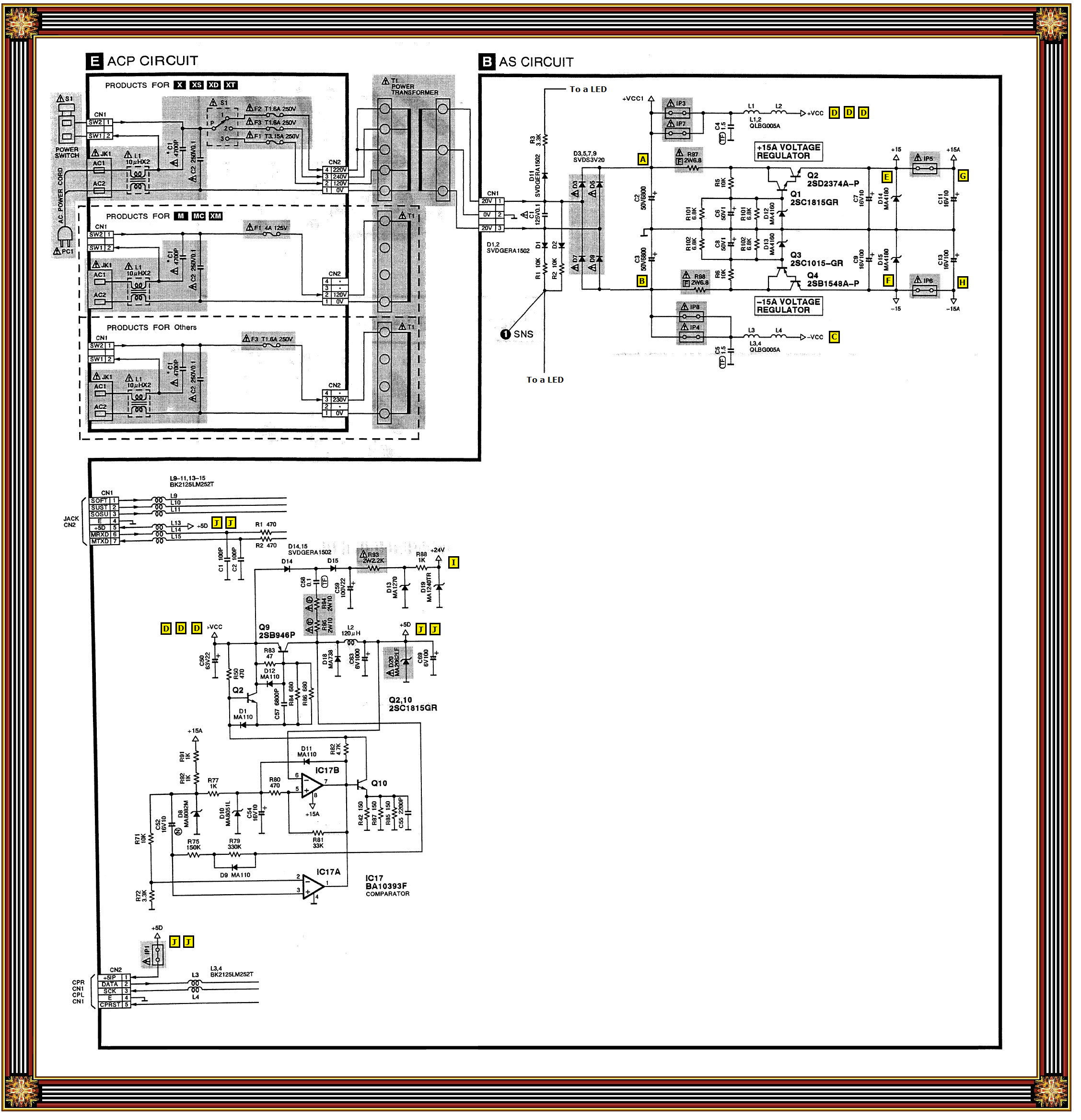

Here is that units POWER SUPPLY CIRCUITRY all amassed together as a compact unitized schematic.
It originates at the power transformer at top left and flows to the right and there are SEVERAL marked points to check due to the great number of circuit protectors used.
THe DDD +VCC goes down to the bottom left where it is marked up again as DDD and is processed down to a +24 VDC supply and a +5 VDC which exits at JJ at Jack CN2.
It also passes as JJ at CN2 after, first passing thru a circuit protector.
ORGANS UNIFIED POWER SUPPLY SCHEMATIC . . .

I was able to locate CN1 and CN2.
Unfortunately my expertise in checking those points that you mentioned on the schematic, is very limited.
Unless you are willing to guide me thru, what exactly I should be doing, in small steps...

Relevant to your lower AC voltages from the power transformer secondary windings, if they are reading high that could be indicative of some connector is not plugged in, so that a portion of the loading of the supply transformer is not there, so the voltage would be high until that section is properly loading down the supply and pulling the supply voltage on down to a normal value.
I need a more specific connector identification . . . relevant to the . . .
But once the connector is put into place by connecting the two PCB's the voltage at the 34V DC drops down to less than 1V.
Lets ignore AC readings for the present and your meter negative ground connection will be the common center junction of the C2 and C3 main filter capacitors. That is being half way between YELLOW A and B test points.
We will be doing mostly + DC voltage readings, with a few B-C-F and H negative voltage readings.
You say
WHAT CONNECTOR ? AND IS THAT possibly being TEST POINT A-D-G or E ?
Voltage across Super Capacitor is 900mV.
Yo nevah gonna see that come up, until the 5VDC supply is active.
If you can get the initial A-H readings that would have voltages from all test points, and a need to move to the small supply for the 5VDC and the minor +24 supply at the bottom left of the schematic / cartoon.
If you get something in the order of that 1VDC reading (Where?), we need to power down and move to ohmmeter function readings to see if we have a shorted semiconductor (s).

Primary winding gets 125V AC from the wall outlet.
I get 78V AC in the secondary winding (half of that is 39V AC instead of 20V like the schematic says). Everything is plugged, no connectors hanging in the air.
I was only able to check the point A and point B (to ground), I got a DC reading of 52.8V.
For the other points E, G, F, H. >>> I have no clue how to find them, I would need help with that.
For the 34V, I included a photo. This connector is located between the Main Board and the other PCB board with the two giant Capacitors.
When the connector is in place instead of the 34V I get a reading of 1.3V DC, but this might be irrelevant.IMG_0118.JPG

I believe that after reading your RED LINED connector info, that we can assume that your +15 and -15V supplies are being good, and now you can track the component trail from A up and to the right to DDD.
I might equally assume that your voltage drop situation of 34V down to 1.3 is one of the two lines that I show as feeding to a LED. When you complete a circuit continuity with it via a plug / connector the voltage drops . . .as it should . . . since that line was previously being totally unloaded.
ICP's are Current Protectors / fuses and you will have to identify its / their physical appearance by finding one by its symbolization assignment that is being silk screened next to it on the PCB, I remember 3 different casing profile variations being used thru a 40 year span of years.
Once you confirm voltage at DDD, then move to the PCB that has the two power supply voltages that I have shown in the lower left inset schematic.
There you will see how the same
DDD is being connected in there and it primarily feeds to the right to Q9 power transistor.

Moving on to the next Point to check >>>> + VCC D D D >>> TOP of the Schematic !
I located the two Circuit Protectors >> IP3 and IP7, also found L1 and L2 (are these inductors?). I saw a big red component, underneath it had a capacitor symbol, I couldn't read what it said on the side, on the photo I marked this component with 3 yellow question marks. I would assume that's the Capacitor #4 TF 1.5.
I noticed that +V "thru hole" I put my test lead there. See photo, that's how I got a reading of 52.6V DC for DDD.
Quote:
"Once you confirm voltage at DDD, then move to the PCB that has the two power supply voltages that I have shown in the lower left inset schematic.
There you will see how the same DDD is being connected in there and it primarily feeds to the right to Q9 power transistor.
This is what I'm going to do next.

Here is the schematic for that +24V and +5D, I broke it up into a separate segment.

I was able to locate point JJ for the +5D at Diode #20. I got a reading of -227mV.
For point " I " I couldn't do any testing, since Diode #19 is totally missing from the PCB. I took a measurement from Diode #13 it was like 500 mV.

The lack of that component (and the associated lack of components near it) suggests that for your model of the digital piano, a part of the power supply is not required (perhaps it supplies a voltage rail that is unused?).

Some of those readings you give are way off, bit like you are not measuring correctly. Are you sure you have a ground connection and you are on the right meter scale?

I use the ground connection which is a black wire that comes out between those two giant capacitors and it is fastened to the board with a screw.
You can see the ground cable in this photo.
There must have been a production change, as this is a minor supply, as it starts, at the left, it is taking its initial power with steering diode D14 from our DDD supply point then to the right thru additional diode D15, then gets some filtering / isolation from C69 then passes thru the 2.2K resistor and the D13 zener diode which is supposed to initially regulate down to a 27VDC level.
Now if the previously described parts are installed and DDD is powered up and only 500 mV is at the D13 cathode at the top . . . . it could possibly be suspect of being crunched.
HOWEVER the physical size of D13, which I am seeing is only a 500-700 mw power rated unit, I would suspect that position to be minimally be incorporating a 1W or + rated Zener diode.
You might do a power down test and see if that diode is shorted, otherwise I think that they have made a mod on / for this ones +24VDC supply port source .
I have two phantom board views of that small, dual portion power supply that we are looking, but they are totally displaying as black and white, with no intermediate shades of gray, for definition, so I can't find any landmark parts of that circuitry to tell you where to look for it..
