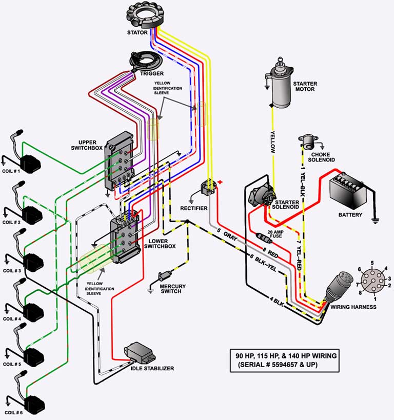

32Vwasbetteronboats
Feb 18, 2017
80
Feb 18, 2017
80
Maybe a switch-box from a mercury outboard for part of this, it only needs a few volts to trigger it.
My suggestion really is to look at what the outboard motor racing guys are up to for ideas.
