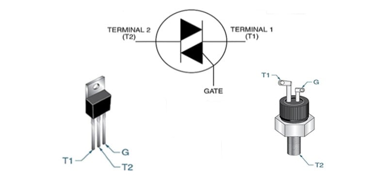

I got a DM from @73's de Edd - aptly pointing out there seems to be room already on this little PCB for a TO-92 (the little one there) and at TO-220 (the 3 holes, unused). I do have a NTE5638-06 TO-220 from another project that might work? I could just remove the TO-92 and install that TO-220?
Metering-wise I'm not sure how you test/measure a functioning (or not function) triac?

  1. Set the DMM on the Ω scale.
  2. Connect the negative lead to the main terminal 1.
  3. Connect the positive lead to the main terminal 2. The DMM should read infinity.
  4. Short-circuit the gate to main terminal 2 using a jumper wire. The DMM should read almost 0 Ω. The zero reading should remain when the lead is removed.
  5. Reverse the DMM leads so that the positive lead is on the main terminal 1, and the negative lead is on the main terminal 2. The DMM should read infinity.
  6. Short-circuit the gate of the TRIAC to main terminal 2 using a jumper wire. The DMM should read almost 0 Ω. The zero reading should remain after the lead is removed
