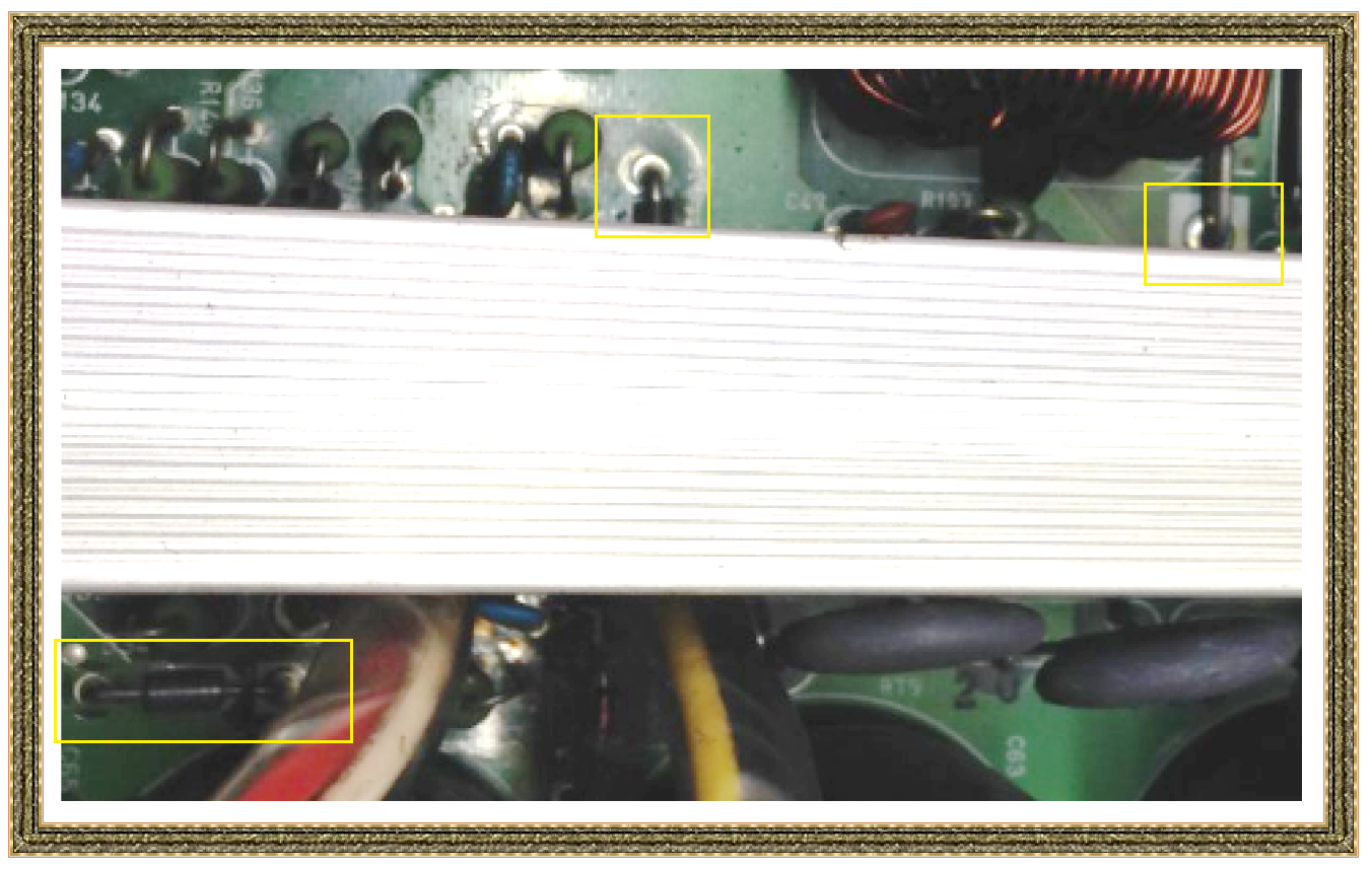

An update.....
I tried fitting the new diode and no change. I re-soldered joint thinking maybe dry and stupidly managed to short something :(
So now source light won't come on either. I think it's time to give up as I can't fix one fault let alone two lol.
One question before I hang my soldering iron up for good and return to playing with mains electric.....
The diode in question on closer look doesn't seem to go to the capacitor bank. It seems to go to a whole in the common on the PCB and not connected to anything? How is this possible? I will attach a pic to see if it makes more sense. The pic is hard to make out as usual (need a better camera) but you have the common copper sink then just a circle with just PCB plastic in middle
Cheers
Steve failed electronics engineer :)

Sir Steve Goldson . . . . . . .
Alas . . . pity . . . . . on the situation now.
Using your photo referencing and my digital enhancement, within its limits, and a blow up, to its pixelation threshold.
We now have:
(Un-mag to catch the additional bottom text )
I have picked / marked up three areas of interest, with the top two being better lighted..
This is a double sided board and for high current or reliability aspects they are using a hollow brass or tinned non ferrous rivet for feed thru, from one side of the board to the other.
Center top, what looks to be a diode lead, is passing into that rivet , BUT there is also a large circular fillet of solder built up around that ground plane.
Over to the top right the is a wire that passes onto that rivet and makes connection to the other side of the board.
NOW . . . . the one in the area that I think will be relevant for you . . . will be the bottom left one . . .where you see the same connection manner being used .
The first stupid question to now ask, is if you . . . for sure . . . installed the replacement diode in the same polarity orientation as the old one was.
If that power supply is not now impaired enough to be blowing a fuse . . .you certainly still have a possibility of getting the unit operational again.
Now, take DVM in hand and check out all of the units diodes .
Place instrumentation in Diode test mode and be expecting a ~600-700 millivolts diode forward voltage read on common silicon diodes or in the ~400-500 millivolts for fast switching diodes or lastly down in the 200 mv vicinity for most of the Schottky diode family. ( OH . .make that . . . hot key . . .if you trust spell-check ! )
I certainly hope that you find one or more bad diodes now.
Then we can proceed to power devices.
OOOOPS . . . . I forgot post #14's photo.
Hmmmmmmmmmmmmmmmmm . . . . . . is that an algae cluster at the bottom of the Sargasso Sea ?
73's de Edd

Hi 73's de Edd,
Firstly when I realised a double sided board I had a dry joint on the diode I fitted as its in a tight space.... Sorted that, pretty sure it's the right way as a little diagram on the PCB to show direction. Diodes on testing seem with in range, but I will continue testing next week as I was called off the job.
