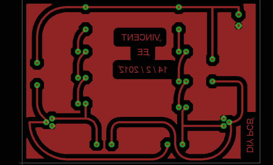

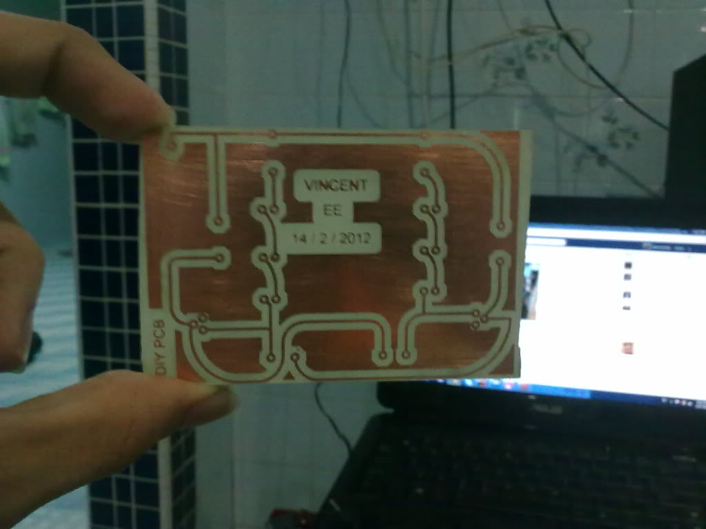

Just something to be shared
Give some comment about that for further improve.
Thank you
Yea..I am one of themHehehe..First Year EE student
Oh. The guy in the left.

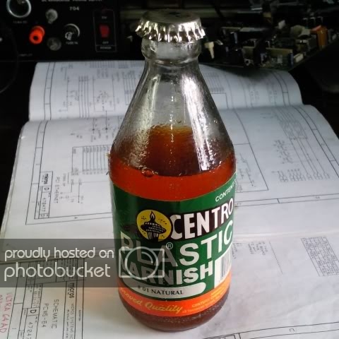

How come you did not show that you have to laminate the finished pcb w/ Lacquer Varnish to avoid finger print mark on PCB etch that will cause corrosion?
you mean solder mask ?
I didnt use anything for protection...suggestion for cheap and easy protection?
Need to ask..hahaha..how to use that and the purpose is to protect the connection?
Do you have this in Malaysia. Its cheap.
One of the the "correct" types of coating is an acrylic. It probably differs from varnish in that it has a known dielectric constant and resistance.
But I've never had problems with the excess conductivity of varnished wood...
I suggest that as long as it sticks to the board and the copper, and burns/melts away with the temperatures used for soldering, it will probably be OK.
The coating is unlikely to be thick enough for it to sustain a flame (especially over copper) so the risk of it all burning off has to be quite low (once it's dry of course).
Hey, besides laser printer , what printer that I can use to print the layout ?
EPSON printer can ?
