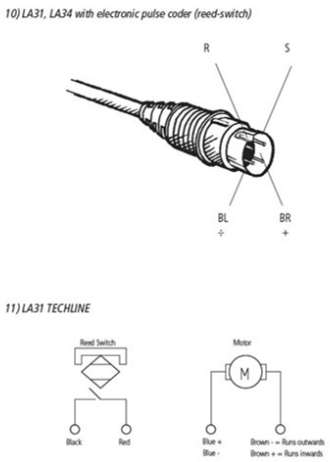

I found some more information on the LA31 actuator. It's not a wiring diagram, but it mentions a 'Reed switch' and shows a small diagram (shown below). It is on page 100 here: http://catalog.linak.com/Linak/ENGLISH/USERMANUAL/LINAKLinearActuatorsandElectronicsUserManualEng/
Is this sufficient information, or should I look for a different make/model?

That gives us enough info. It is exactly what I was expecting.
Spec sheet says the actuator should be run at 10% duty cycle for continuous use, or can be run completely on for 2-min, but will require a lengthy rest time.
The motor will require an H-Bridge to drive. If the spec sheet claims there are limit switches, they appear to be internal to prevent damage from attempting to move the actuator further than designed. I will attempt to verify this.
As far as the actual control goes. You can use the reed switch to determine it's location (as well as if it is still moving)
Is your plan to use 4 of these? Or are you still considering a scissor lift?

Great. I vaguely understand the figure. I will go google 'H-bridge' :)
The duty cycle won't be a problem. Basically, it will lower the projector for less than 1 minute, then be shut off for at least an hour or so (duration of a movie).
My plan is to use a single actuator. The cylinder/rods will guide the box, and keep it from hitting the ground in the event of total failure. The actuator will be tethered to a wire, which is at the center of the box. I will draw up a sketch to better explain that part.

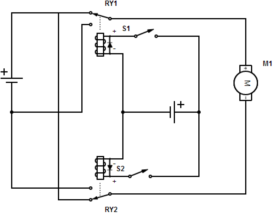

Ok, I think I have managed to come up with something that should work. I learned a great deal in the process. Should I be wrong, please so tell, and I'll have learned some more ;)
This is what I came up with. S1 and S2 are the outputs of my home automation system. The left power source is a 24V 5A DC power brick. The middle power source is the 24V DC 500mA output of the home automation system.
Next step will be to find the right components for the job. (Assuming that I won't kill anyone with this wiring)

Looks good to me.
Only possible change would depend on the 24V power brick you are using. Does it have a ground by chance? At rest, the motor is connected to 24V at both it's terminals. In an automotive application this would be asking for trouble, if either wire shorted to ground you'd have a fault. This is only the case though if your brick actually has a path to ground, and should be no problem if there is a transformer in use.
Someone else may have a clearer outlook on this.

I have yet to order the power brick. I must admit that I don't entirely understand when this can become a problem. I would prefer to be on the same side though.
Are you talking about if either wire internally in the PSU were wired to ground?
Yes exactly.
It would not be a problem otherwise, and if this was the case, your motor would be at rest 24V above the ground reference. Simply swapping the two relay's neutral position will let you pick if your motor rest at 24V or 0V. Again, only a concern if the power supply's output is not isolated from mains or earth ground.
I may be paranoid, I was hoping someone would jump in with real world advice as I am basing my information on a similar device for automotive purposes. (Window and electric lock drivers)
