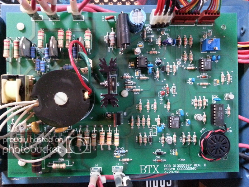

I bought this item for 5 bucks at an live action. I figured the transformer and caps would be worth 5 if it didn't work. Well I figured maybe I can sell it. It seems they still sell for 500-700 bucks refreshed. Maybe I can get a couple hundred. Either way I am happy to just tear down and learn and keep parts if all else fails.
So I am after a few things.
1) I want to know if my Fluke 83-III is good enough to test this equipment.
2) I would like to know what groups of various component systems are called on this thing (power supply, capacitor bank ext.)

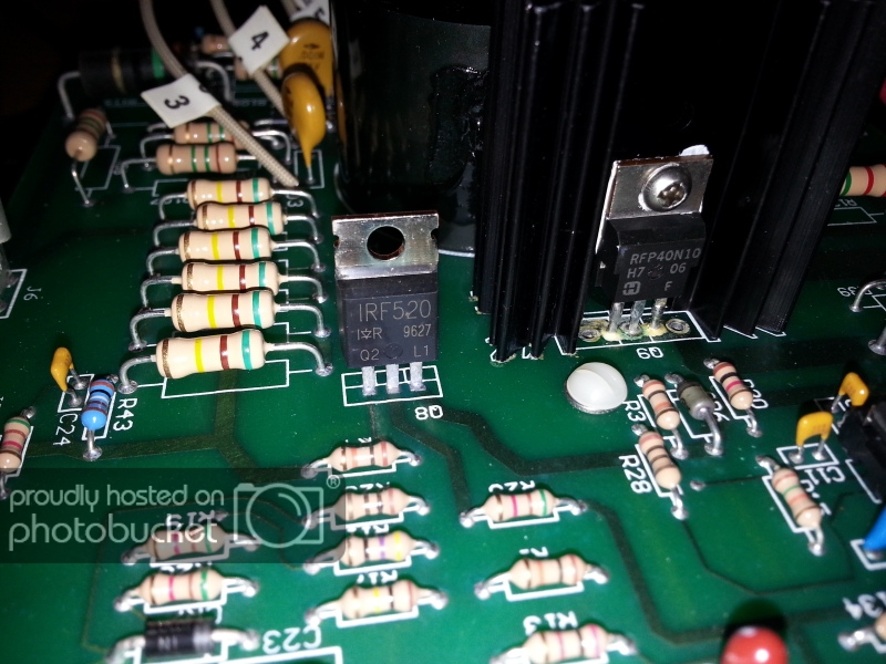

3) One of the MOSFET's have some weird colors on the solder and I was wondering if it looks like a problem to you.
4) Maybe we can walk through and trouble shoot this for fun. If it takes 6 months it is worth it to me.

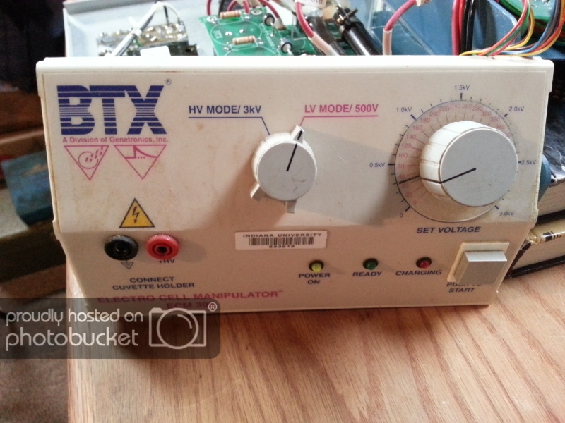

Front Panel
Mainboard

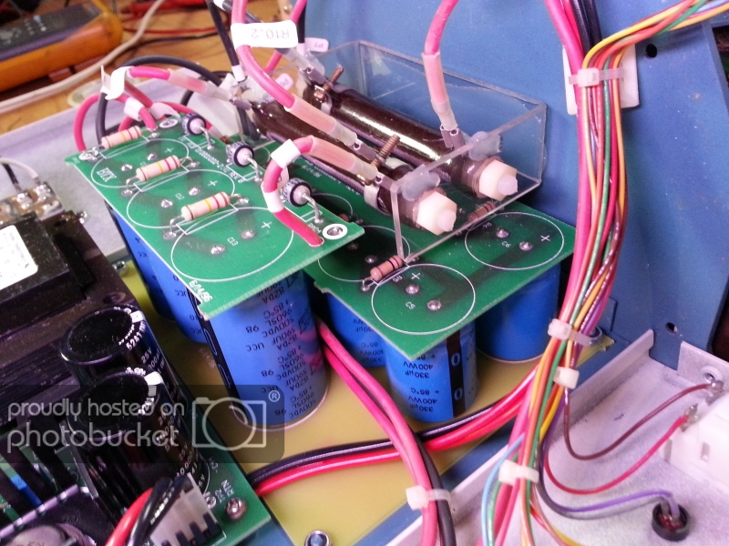

Capacitor Bank

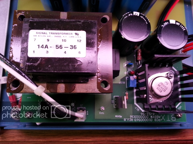

Power Supply
N-Channel MOSFET

Firstly, pictures are very useful, thanks.
Images of the back side of the boards are also useful, but perhaps not needed yet.
Are you talking about Q9?
The solder joints look odd. Worse, the middle lead appears not to be soldered (or very poorly soldered.
I would retouch these joints (and add more solder to the middle one).

Size or number, or even the existance of caps is no measure of danger.
It all depends on the voltage that's present and the impedance of the voltage source.
High voltage and low impedance can kill you.
High voltage on capacitors (and I'm talking anything over 50V where it starts to get dangerous) is a particular hazard because they have a low impedance.
There's more to it, but the simple thing is that this unit deals with voltages that are well into the dangerous area, and possibly verging on the extremely dangerous. Fortunately they fall just below the stupidly dangerous.
(I hope you're getting the message here)
