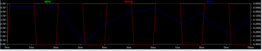

I am trying to understand the below circuit
My analysis of the circuit is since 5V is connected to both ends of the circuit there will be no current flow. Is it correct? Anything more i can understand from this circuit, this circuit is created by me to analyze different ways.
No, the transient source, V2, is not constantly at 5V

I get 0 Amp.
Is it that i shall not do transient analysis for constant voltage supplies?
Yes, you can do transient analysis with constant voltage supplies.
Why would you expect other than 0 amps?
Can I assume this also as 0 amp current since it is in fA?
Yes, that value is approaching the precision of the Spice calculations.
I don't understand the behavior.
What don't you understand?
With zero voltage across the components (the same signal from both sources) you get essentially zero current, as would be expected.
If you want to see some significant current, then make one source a DC voltage.

Since the current seem to be fluctuating increasing and decreasing instead of a straight line.
Yes i am trying that i will show.
crutschow
May 7, 2021
991
May 7, 2021
991
But that's a very tiny current, likely to the limits of the computing precision in the simulator.
No matter how many digits the current is computed too, it may never be exactly zero.

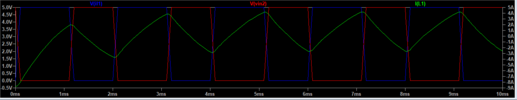

Your calculations are good in the first part (0 ms -> 1 ms).
In the second part (1 ms -> 2 ms), however, you ignore the term (v1-v2)/r and use the result from part 1 to calculate a decaying current. What is your reasoning for doing so?
Consider instead [math] i(t) = \frac{(v_1 - v_2)}{R} \times (1 - e^{(-\frac{t}{\tau})})[/math] for [math] t \rightarrow \infty[/math]

The circuit i have drawn and the results i am getting are completely mismatch, i think the circuit is wrong or the spice is not doing the simulations properly.
