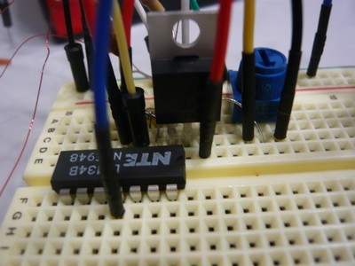

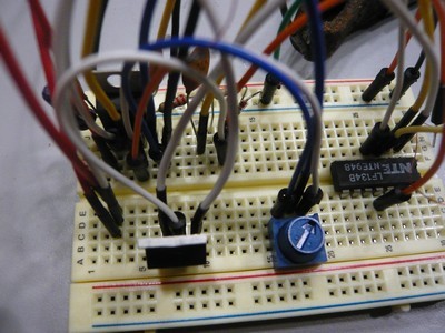

Here are a few pictures of the circuit, in case these help in any way:

The lead-acid battery charger probably does not produce a clean DC output. They often have no smoothing capacitor, so their output voltage is just a full-wave rectified signal at twice the frequency of the AC mains supply. This is probably the reason for the buzzing sound.
You need to power the circuit from a proper DC power supply, rated for at least 1 amp continuous output current. The electromagnet, with a DC resistance of 25.5 ohms, will draw up to about 0.6A. This is calculated using Ohm's Law: I = V / R where I is the current in amps, V is the voltage in volts, and R is the DC resistance. The actual voltage is probably not critical; you can probably use just 12V, for testing at least. So put the battery charger back in the garage and try to find a 12V DC power supply rated for at least 1A output current. Don't bother with the two NiMH cells.
Re the physical layout, it is not clear to me from that photo. Can you draw a diagram showing the whole assembly in two or three dimensions. This should include the connection polarity and winding direction of the electromagnet, which face of the Hall sensor is which, approximate dimensions and distances, and the shape of the magnet you are trying to levitate, along with any mechanical restrictions or guides that act on the magnet. Also, the manufacturer and part number of the magnet.
Why have you wound your electromagnet on an iron nail when the original project seems to specify a plastic spool with no core?

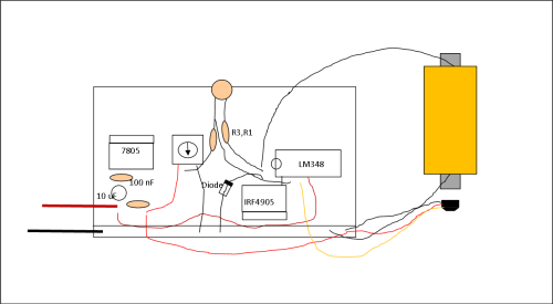

Here is a (crappy) drawing of the physical layout:
Per the electromagnet winding direction, it was wound counterclockwise (when viewing the bottom) up and down the length of the nail several times (155 feet goes a long way).
Do you mean the electromagnet? I wound it, at home, with some magnet wire... As for the neodymium magnet, I have no clue as to its manufacturer, and magnets don't have part numbers. If you mean the Hall Effect Sensor, it's an A1302 I bought from JameCo (unknown manufacturer). Possibly manufactured by Allegro Microsystems, as that's where I found the technical sheet.
Why do you mention pins 2, 3, 6, and 7 per pin 4? I used pins 1, 2, 3, and 4 per pin 11, shown here: http://www.ti.com/lit/ds/symlink/lm348.pdf

I guess you forgot to mention that you're using an LM348 instead of the 741 that's specified on the schematic. In that case, yes it's those pins you listed.
Re the physical diagram, sorry, I didn't need to see the circuit board, only the electromagnet, the Hall sensor, and the location of the magnet.
I don't know much about magnetism, but I think there will be an issue with the way you've done it. Have a look at how the electromagnet, magnet, and Hall sensor are positioned in the original article. There's no core in the electromagnet, and the Hall sensor responds to the magnetism of the magnet; the intensity of this depends on how close the magnet is to the electromagnet, which is how the circuit regulates this distance.
With the arrangement you show, the Hall sensor will be affected by the magnetic flux of the electromagnet at least as much as it's affected by the magnetic flux from the magnet. I don't think that will work.
