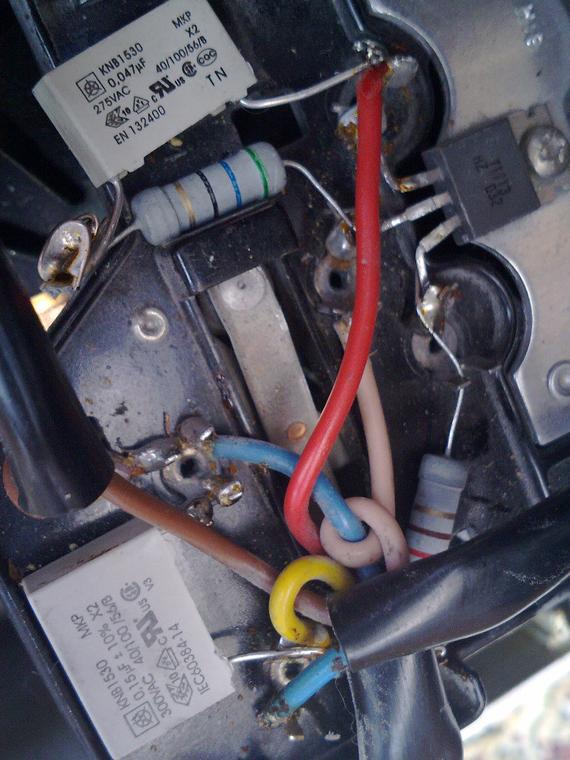

Sir aussiedean . . . . . .
Indeed . . .after looking at the two photos below, that design and parts utilized is evolved from the simplest SCR type of motor speed controller that we would
have encountered initially, waaaaaay back, as early as the late 1960's timeframe.
You only see the poly caps, a couple of metal film, "quasi" power resistors , and the SCR /or/ Triac along with the hidden speed control pot.
All design involvement seems to only be with AC voltage.
I think that the circuit design electrolytic shown, was just a " red herrring" being thrown in, UNLESS you find it to be a non polarized / bipolar type of electrolytic.

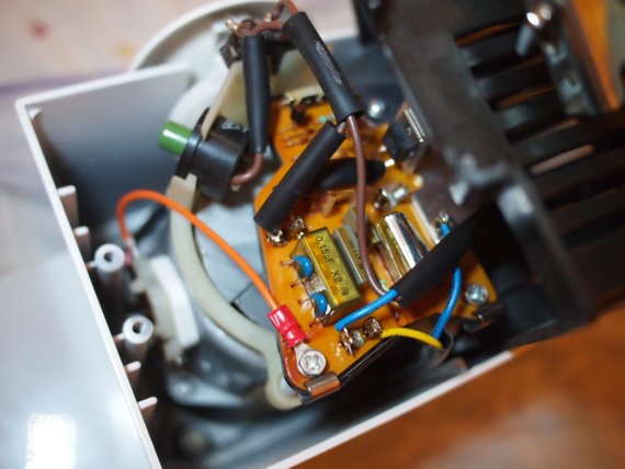

Updated image of the Excel A902 ..... blowed if I can make out the cap though. Problem is the unit is in another country so until the part is removed I'm not sure of the details until it is removed. Just wanted to get the parts arranged before hand.
This item is a Phillips Cap though by the look of it.
73's de Edd
Aug 21, 2015
3,730
Aug 21, 2015
3,730
Ahhhhhhh yes . . . . .and with that view, looks like its haning a very special little power transformer hiding under the wire, feeding low voltage AC to its left with an upper varistor or spike supression capacitor and then a set of (4) 1N4148's configured as a FWB rectifier to get DC and then potentially a yellow Philips Zener diode , current limiting resistor and a series pass transistor to get a low voltage, low current power supply, with the BLUE Philips elecrtrolytic cap left to do its filtering.
And this photo lets us see its negative polarity band around its lower bottom half..
A measurement from the commmon negative buss . . . all along the bottom row . . . up to the Zener to its cathode at the top should provide the minimum , voltage expected, then add a working voltage cushion factor.
STILL . . . all of the capacitance and working voltage are being non viewable, even in this photo.
In my case . . .eons ago . . . I had some 5 mil thick small rectangular plastic tabs that I cemented mirror quality silver mylar film onto.
With my taking one of those and getting right against either half of a component I can easily read the parts labeling with use of an adjunct bright light.
Otherwise . . . . you are up aginst the fudge factor of just HOW much can I rotate an axial capacitors leads?
OR . . . a soldering iron heating of one lead to get it to release and pull free, and worry about the full board pull, to reinstall it later.
