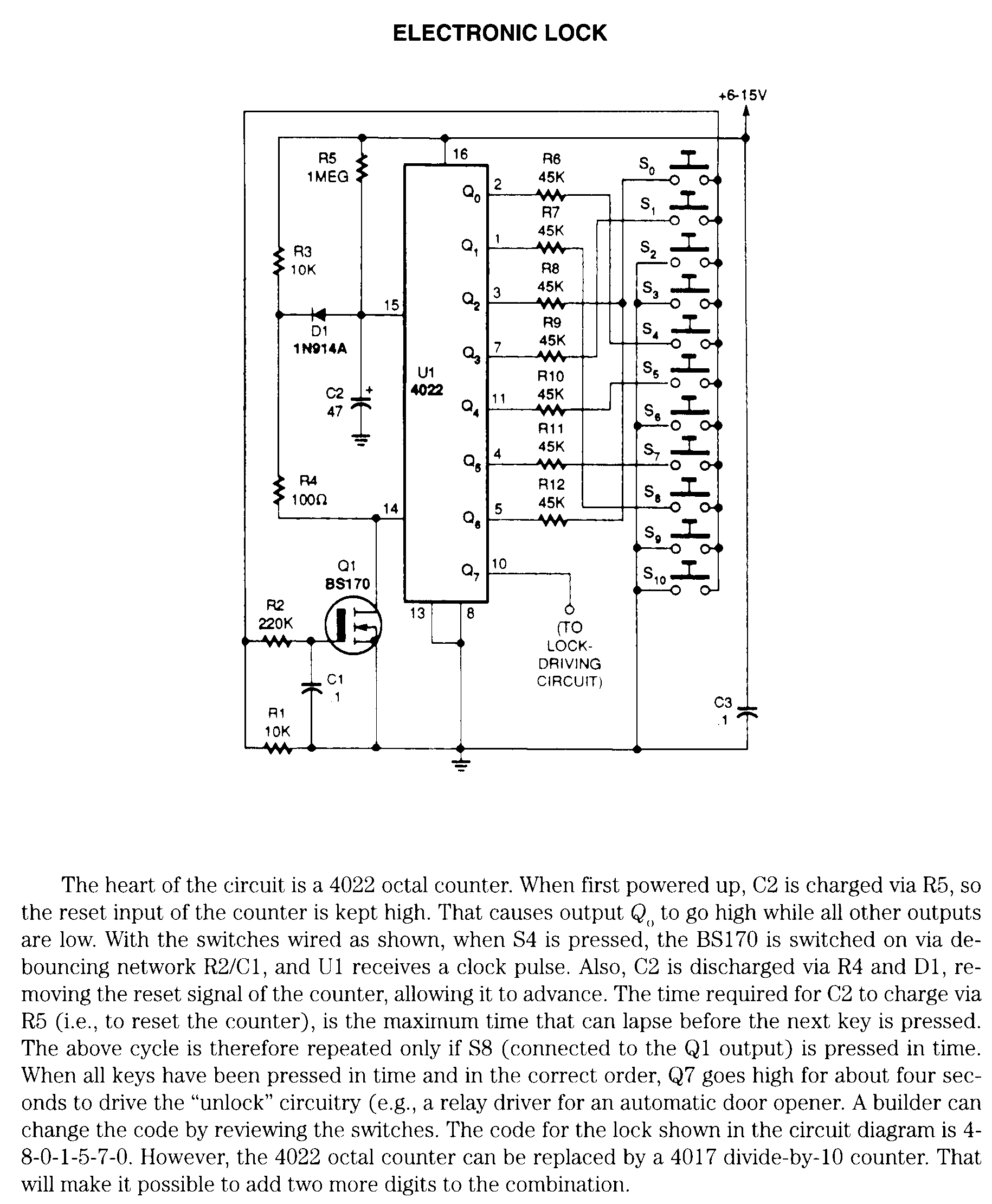

hi, i have decided to make an electronic alarm for my final GCSE project and want a keypad (for a code) i want to know if i can use a PIC to control what the code is? and if it is typed in wrong , the alarm goes off.. is this possible? or will i need a seperate more complex circuit?
Thanks
mike

A Quick Search came up with these circuits.
http://uk.geocities.com/ronj_1217/4d_mod.html
http://www.amarkham.com/andrew/pic_alarm.htm
