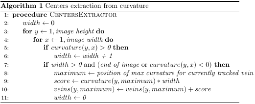

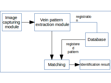

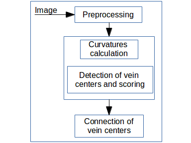

I planned some sketch outs. Here it is.
Infrared is commonly divided into three regions that is near, mid and far-infrared light, but the boundaries between them are not agreed upon. There are two choices that focuses on imaging of vein patterns in hand by infrared light, the far-infrared (FIR) imaging and the near-infrared (NIR) imaging, which are suitable to capture human bodies images in a non-harmful way
Algorithm for vein pattern extraction consist of four steps:
  1. Image pre-processing
  2. Extraction of center positions of veins
  3. Connection of veins centers
  4. Binarization
I started this implementation in opencv and c++
