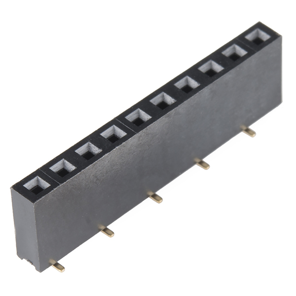

I am working on a project based on an Arduino Pro Mini controller.
My idea is to have two 12-pin rows of male header pins soldered to the Pro Mini (on the long sides) which are to correspond to two 12-socket female headers on the PCB. Problem is that the design calls for a one-sided PCB and I can't see how I can solder the female headers (sockets if you will) to a one-sided PCB.
How can I get round this one?

Why would it be difficult to solder a female header to a one sided PCB?
Because the plasticized\ bit (the socket) sits on the copper where I want to solder. :( I could poke the pins through from underneath and have the Pro Mini on the opposite side of the board from the other components, but that would seem a bit odd. :confused:

You can use a socket without plastic case like this one. After soldering the sockets in place, which is easily done from both sides or one side only, remove the carrier and insert the chip or whatever goes there.

Sounds like you're mounting the components on the copper side of the board SMD-fashion. You can easily bend the legs of a standard DIP socket outwards to solder to pads. If you want to be 'fancy' then design the board for the Arduino chip itself and solder ALL parts to it - not just the 'carrier board'.
