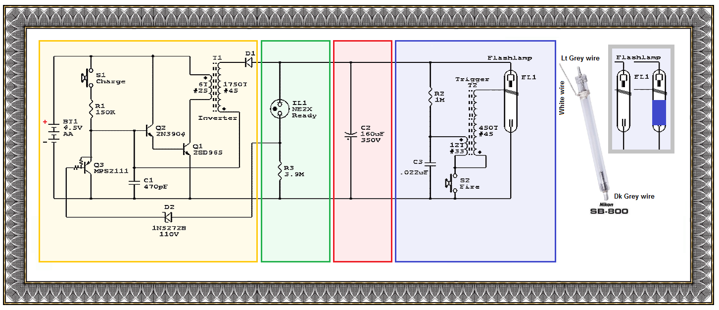

SIr Sony guy . . . . .
Here is a basic reference schematic that I have sectionalized and marked up its relevant sections.
I didn't catch this post until just now.
Looks like you now have yourself a dedicated cap tester also.
From the snippets of info that you gave, it was then possible to make some assumptions.
PSUEDO SCHEMATIC REFERENCING SOURCE:
The YELLOW area is the DC-LV to -DC-HV supply unit which charges up your HV C2 flash storage capacitor.
YOUR Nikon units circuitry is much more complicated and even uses a u/p.
The GREEN area is the charge / ready inidcator for the state of charge on your C2 storage capacitor.
It uses a NE-2 neon lamp which usually fires and flashes orange when a DC voltage ramping on up to a 60-75 volts threshold is being across it. In this case, the 3.9 meg series dropping resistor has shifted that detection threshold on up towards >300 VDC. A red plastic filter is used with its orange light output.
The RED area is the main flash storage capacitor. . . . . lots of DC power gets stored up in that unit, and tracing its wiring down, shows that it is being constantly across each of the end electrodes of the flash tube.
The BLUE area is the flash tube and its trigger circuitry. The trigger circuitry is where the magic evolves.
All of the time that the main storage capacitor has been increasing its voltage level of charge, simultaneously the R2 1 meg resistor has been charging the tiny C3 capacitor . . . which it can do almost instantly . . . with it being a mere .022 ufd . . . . but its voltage level slowly raises to track the C2 charge voltage level.
By the time the READY light of NE-2 IL1 comes on . . . . . all is ready for flash time.
S2 would be your manual or test flash switch.
On your unit I would expect it to be SCR design related, so that electronic slave or bounce flash triggering could also be accomplished
For a test flash, if S2 is closed the 300 or so volts accumulated within C3 is dumped into the primary of the T2 trigger transformer which transforms it upwards to a multi kilovolt pulse at its secondary windings output which is connected to the trigger band of the flashtube.
Up until this time, that xenon gas presence within the tube was a non conductive insulator between the two opposite electrodes that are now resting at about a 350VDC charge level.
That HIGH VOLTAGE pulse causes an ionization of the xenon gas sealed within the flashtube, making it a conductive plasma now.
The end electrodes now use that conductive path to dump their charge into and . . . . KA- BAMMMMMMMMM . . . . there is being one brilliant flash of light.
Then the DC-LV to -DC-HV supply kicks in to start another capacitor charge up cycle to be ready for the next flash.
OBSERVATIONS
When you mentioned the varying charge up sound that the DC-LV to -DC-HV supply makes . . . . it starts up well loaded down by virtue of initially dumping into a depleted main capacitor and as the charge accumulates its job gets easier.
That sound shift suggests of a non leaky and properly charging main capacitor.
If the READY light comes on . . . it is charging well up into the hundreds of volts.
Triggering circuitry or flash tube is now suspect. Flash tubes usually fail by getting gassy or fai by cracking right across the the tube . . . . leaving you au partum deux.

You can test the triggering circuit output with something you might already have .and that is a NE 2 lamp and its dropping resistor in a slim bakelite stick . . .called a Flick-R-Lite . . has been around since the '40's as a cheeeep AC line tester for power presence in home wiring.
Itsalookalikeadis . . . .mammamia
https://fthmb.tqn.com/7sdCH5O2dBnhb...bout/neon-tester-56a4a2ed5f9b58b7d0d7f061.JPG
You just connect the leads between camera shoe ground and the WHITE trigger wire that connects to the multi turns of wire band at the point shown on the Nikon parts drawing.
Then power up the flash until the ready lite light state and then manually trip the flash and expect a noticable, quick orange flash from the tester.
ALSO you might even happen to have a naked neon lamp itself . . . ( I think that my supply has declined down into the 300's )
ALTERNATIVE TEST
On this one you feed in a predermined width of aluminninny-yum-yum foil and snake round the tube such that it covers the BLUE markup. of the illustration.
Its width needs to clear the electrode at the bottom by ~1/8 in so no arc will be made to that.
on its other end its width needs to clear that trigger wire coil by a like amount, since that triger transformer secondary is being a dead short to kilovolts.
Two tabs of aluminun can come out the font so that an alli-fum-a-gator clip can hold the band in place.
Now if it were only a low humidity winter and you wore rubber soled shoes and dragged them across a wool rug and touched that new ersatz trigger band . . . . if the tube was good it would flash when your finger touched the new band.
ALAS not to be . . . . .
So you get out your electric match / fire starter . . . or cop one from the DOLLAR store.
A . . .La . . .
http://i.ebayimg.com/images/i/351020654295-0-1/s-l1000.jpg
On this unit, the central electrode arcs over to the side shell to spark . . . .
in that case an inserted insulator is needed.
On my unit, it had a small barb that it flashed to.
I just had to bend that barb back far enough so that it no longer makee sparkee . .just its HV presence from the
center pin electrode, initiated, upon a sharp piezo whacking by the trigger pull and its hammer drop gainst te piezo element .
If you will then wrap that units handle area in alum foil . . . .excepting leaving access to the trigger . . then ground the foil with a wire to the hot shoe ground.
Ready the flash up to RED light time and touch the " electric match " HV electrode tip to the new trigger band , finger trigger the match amd expect a flash emanation from a good flash tube.
If these alternate option tests for the triggering circuitry fail . . . suspect the flash tube proper.
