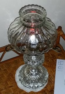

I have (what I think is) an old oil lamp that used to be my grandmother's which was converted to electric and it has a flickering flame bulb which I think uses neon. The problem is that the light is so dim that it's essentially useless and only serves as a decoration. I wish to use flickering LEDs to increase the light to a useful level. The lamp is in the hall and I only need it to produce enough light to get between the several rooms in my apartment connected by this hall.
1. LEDs
I intend to use these flickering red, orange and yellow 3 mm LEDs which I intend to run at 30 mA. The 3 mm LEDs are presumably preferable to the 5 mm LEDs because they'll dissipate the heat more effectively. I intend to grind and polish the LEDs flat or maybe with a convex cone so the distribute their light better. I will use between 14-30 LEDs and I'm not sure what the best colour mix would be.

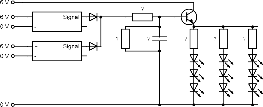

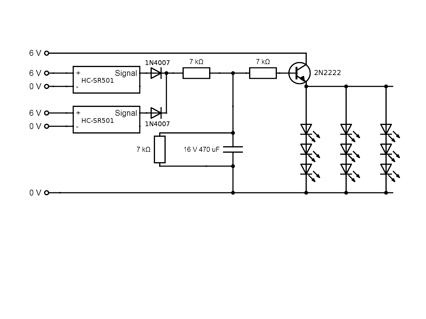

I want to add a small complication to my circuit in that I want the LEDs to fade on and off initially, a little bit more like an actual flame coming on. I've prepared the following circuit diagram using the power supply set to 6 V. The filling of the capacitor slows the turning on/off of the transistor:
How much voltage will drop across the transistor? I think I won't need any resistors to protect the LEDs because their Vf is 1.8-2.2 V each so three will handle 5.4-6.6 V.
Edit: I think I can use the 2N2222 transistor and I'm pretty sure I won't need any resistors to protect the LEDs since they're rated 1.8-2.2 V each anyway and with the transistor there they'll presumably be getting <2 V each.
I have a bunch of salvaged electrolytic capacitors (the ceramics are too hard to find specs for). How about 6.3 V 2200 uF? I also have some 10 V and 16 V but since the signal output is 3.3V, 6.3 V should be enough, right?

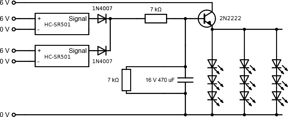

After some more calculation, I think the capacitance should be lower. Here's an updated schematic:
I just need to know the voltage drop over the 2N2222 when it's fully open with 6 V and ~210 mA. Is it negligible? Edit: Yes, the drop will be between 0.3-1.0 V between 150-500 mA so there's no need for resistors in this arrangement (good; I hate those things!) although the drop is not negligible.

That won't produce a dimming effect, the capacitor current will just enter through base straight to emitter, it just go off quickly

I'd use a darlington and a 10f combo with a resistor in series to base

Yeah, I made a mistake with my design. Thanks for catching that!
Does 10F mean 10 uF or 10mF? Not 10 whole farads, right? How does a darlington transistor do this differently? Thanks again.

Sorry i meant 10uf in a darlington pair arrangement (in collector out emitter to the base of the 2nd npn (which is where your circuit starts)
That way, the cap can slowly discharge through the transistor giving a fade

I don't think the saturation is high enough for all those leds, juat from experience, the gain is around 300 for a 2n2222
So 5/7000 is 0.0007142857ma x 300
0.2142857143 amps

Including diode drop, it has to be more than 7k, anyway you'll see

Thanks again. I don't think the transistor in the simulation is working right though. If I give a base-emitter voltage of 2.6 V, the transistor still doesn't fully open? This isn't right for a 2N2222 is it?

It is right yes
You need to place the leds between the 6v rail to the collector of the transistor exactly like the way i did it in my circuit i posted
