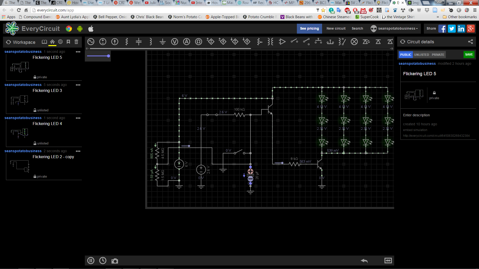

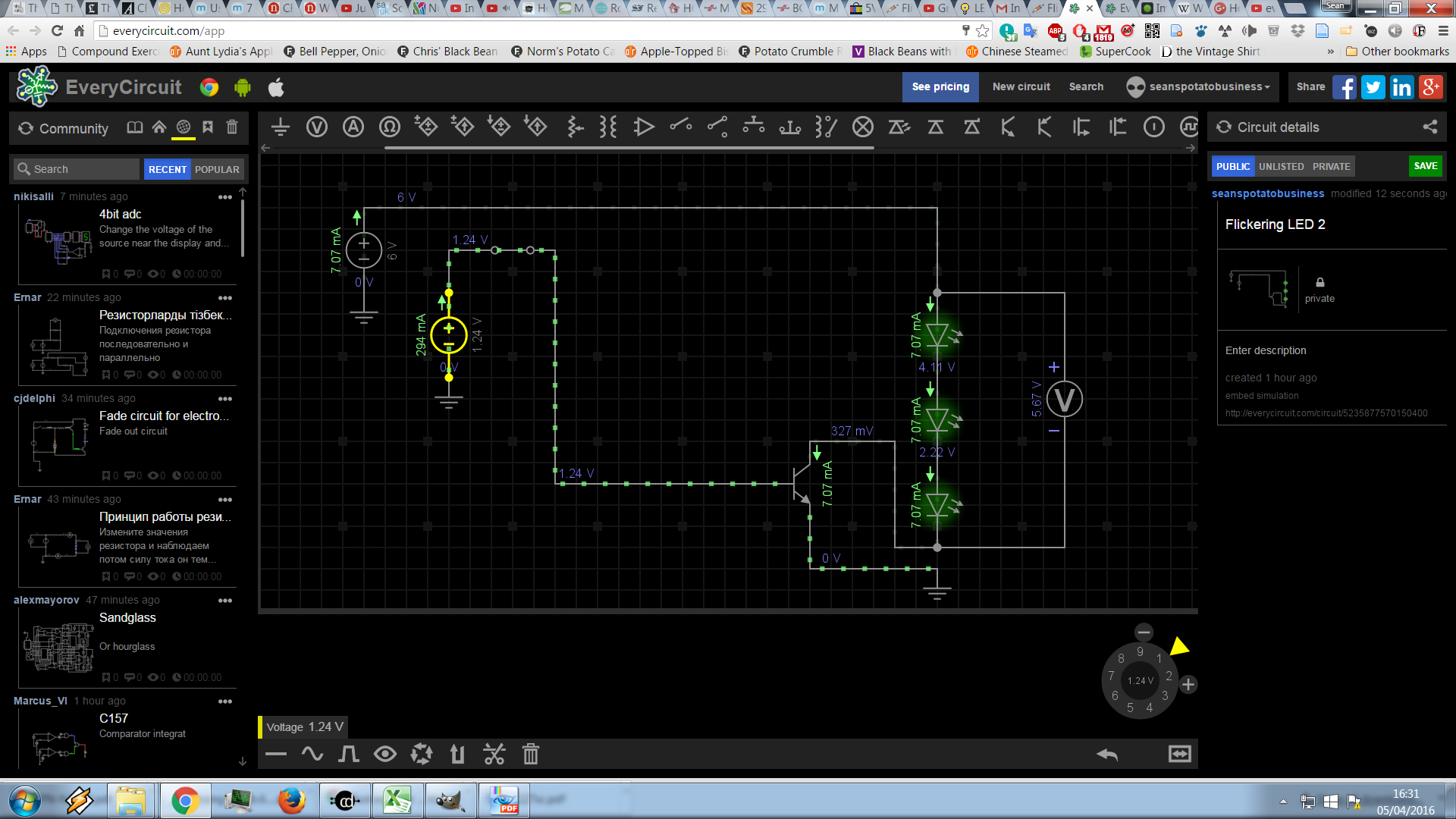

You need to place the leds between the 6v rail to the collector of the transistor exactly like the way i did it in my circuit i posted
Well slap my head and call me Sally! I didn't realise that was how it worked!
This also doesn't make sense though! Now when I increase the voltage to the base of the transistor, the LEDs get dimmer. That's the opposite of what it should be?

You only have 1 transistor, there's simply not enough current flowing, add 2 transistors like in the schematic i posted, copy the darlington pair

But it doesn't make sense - a low voltage means a smaller current yet the LEDs are lighting up more. It's backwards!

That's because lower the voltage the less saturated and less current flows from base to emitter allowing more current to flow from collector to emitter...
EveryCircuit is a good learning aid
(Limit the current via a 1k resistor to base)

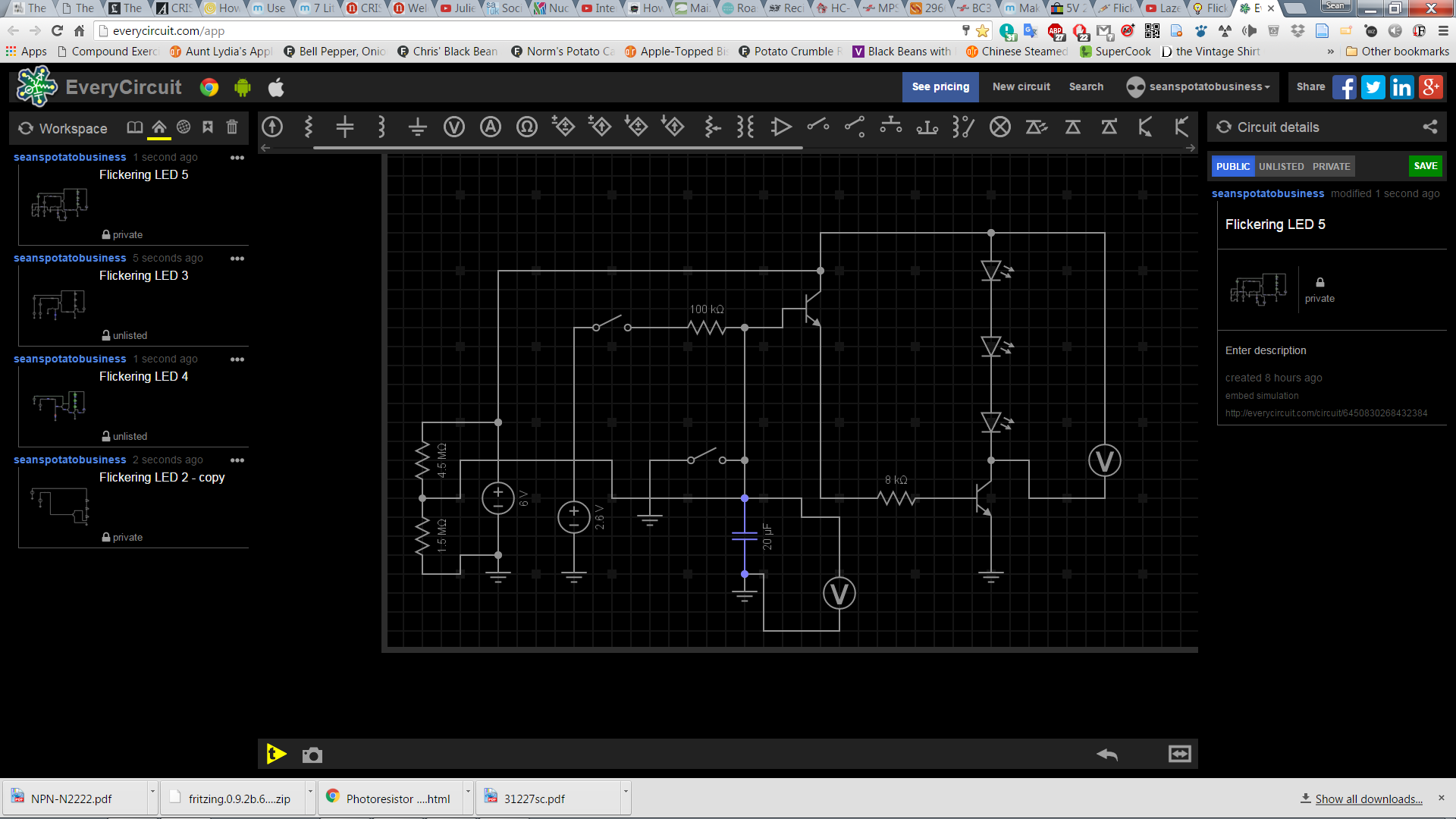

Here's my circuit which uses a lower voltage to represent the PIR output. It's 2.6 V after 0.7 V drops on the diodes. The problem is that the light takes about six seconds to start coming on and once it starts, it's at full brightness in about a second.
Also, do you know how different the Every Circuit transistors are from 2N2222s? Thanks again.

Better to take a screenshot, make your circuit public, so others can help you, from my mobile i can't view your circuit as it loads the browser version

Sorry about that. I thought the circuits would be shareable across platforms.
The second switch on this circuit is just to reset it without having to wait for the slow fade. The first switch simulates the PIR sensor circuit.
When I add more sets of LEDs in parallel, the current gets shared across them and they don't get very bright.
