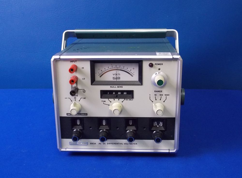

Any one out there still running a FLUKE differential voltmeter . . . . which was GOD's gift of accuracy back in the '60's ?
73's de Edd
