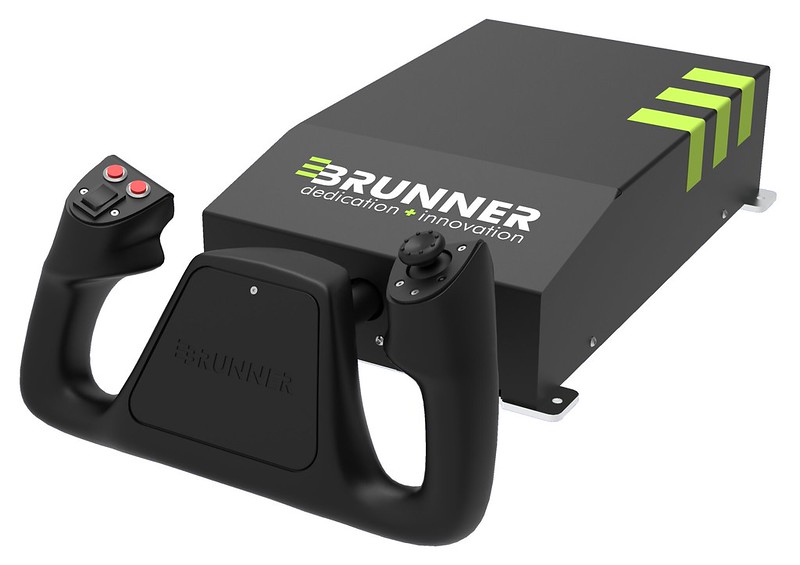

I use to fly myself single-engine airplanes and today I am into flight simulation. I use the Logitech peripherals for the MSFS2020. What I find as being a serious weakness is that the yoke does not reflect how it is on a real general aviation single-engine plane.
An example is the landing process. You make your touch-down in a stall the moment you touch the runway. During the final approach, you feel the pressure on the yoke and this is important feedback when landing a plane.
Being an aficionado of stepper motors you can manage the torque of a stepper motor by controlling the amount of current flowing through the stepper motor. So if the yoke would include a stepper motor an electronic would require information of the flying generated inside an airplane simulator to adjust the amount of current so that the force feedback on the yoke would reflect real-life airplane behavior.
Does anybody know how to get that information so that the electronics compute the torque of the stepper motor in a yoke?

I'm not convinced that a stepper motor is the right tool for the trade in this situation.
A stepper motor is designed to hold its position or move by defined steps. Increasing torque by increasing current will mean in these situations:
- more force to hold the motor's position.
- or more torque for moving the motor.
I have no experience flying an airplane but i take it from your description that what you want is that the yoke can still be moved (otherwise you wouldn't generate the necessary movement of flaps etc.), but that the force required tpo move the yoke depends on the actual flight situation of the plane.
If you were to use the stepper motor to hold the yoke's position, you'll lose the movement of the yoke :(
if you were to use the stepper motor to actually move the yoke against your manual movement, it will either pull back too strongly against your manual movement, or it will not pull strong enough. In the latter case your manual force will let the stepper motor slip giving you a jerky motion.
What I imagine would be a spring that pulls on the yoke. This would give you a linear feedback of force versus position. Now add the motor (be it stepper, servo or whatever) to the end of the spring opposite to where the spring is mounted to the yoke. By pulling on the spring you can increase the tension and thus the force feedback without losing control over the manual movement of the yoke. Equivalently by releasing the pull on the spring you can reduce the force feedback. Like so:
You could even create "negative" torque by pushing on the yoke.
Ditto. Better (and simpler and probably cheaper) than a stepper would be a brushed DC motor, in which both the magnitude and direction of torque are determined by the amplitude and polarity of applied armature current. Then a screw & nut assembly could convert torque from the armature into linear force on the control yoke, with useful mechanical advantage to enable a smaller (cheaper) motor with smaller (cheaper) drive current to generate realistic force.
Bipolar drive is important for simulator realism, because an airplane's control yoke can require the application of force either way.
Push to speed up and/or descend -- trading altitude for airspeed -- ultimately limited by ground contact (!). Hence the utility of engines.
Pull to slow down and/or ascend -- trading airspeed for altitude -- ultimately limited by the stall -- often followed (shortly thereafter) by ground contact. Ditto.
Actually, of course, pulling on the yoke does one thing only -- increases angle of attack. Pushing decreases it.

So, I have made my decision which I want to share with you. Here is the link to the device I bought and which is scheduled to arrive on Monday:
As you can see the yoke is very expensive and yes, it is done using brushless motors. Flying with MSFS2020 is the best left for me after health and finances make it impossible to fly real GA planes. I have only been flying real GA planes and the technique learned to land in airports in Germany and specially in my former home airport EDMJ, Jesenwang, this yoke I hope will make it possible to regain the old "feeling" when flying in the sim
