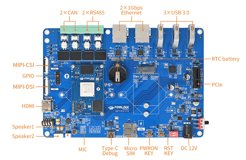

Specifications listed for the OK7110-C development board include:
• Memory/Storage:
• Connectivity:
• Display/Audio:
• Camera:
• Expansion:
• USB:
• I/O Peripherals:
• Other Features:
• Power:
• Mechanical
• Memory/Storage:
- ○ 2/4GB LPDDR4 RAM
- ○ 32GB eMMC 5.0
- ○ 100 Mbps QSPI
- ○ SD 3.0/MMC 5.0
• Connectivity:
- ○ 2x Gigabit Ethernet ports
• Display/Audio:
- ○ 1x HDMI 2.0 port
- ○ 1x MIPI DSI
- ○ 2x Speakers
- ○ 1x Mic
• Camera:
- ○ 1x MIPI-CSI
• Expansion:
- ○ 2x PCIE 2.0
- ○ 1x Micro SIM
• USB:
- ○ 1x USB Type-C
- ○ 3x USB 3.0
• I/O Peripherals:
- ○ 2x CAN
- ○ 2x RS485
• Other Features:
- ○ 1x Power button, 1x Reset key
- ○ RTC battery
• Power:
- ○ 12V DC (via barrel connector)
• Mechanical
- ○ B2B connectors (3x 80-pin)
