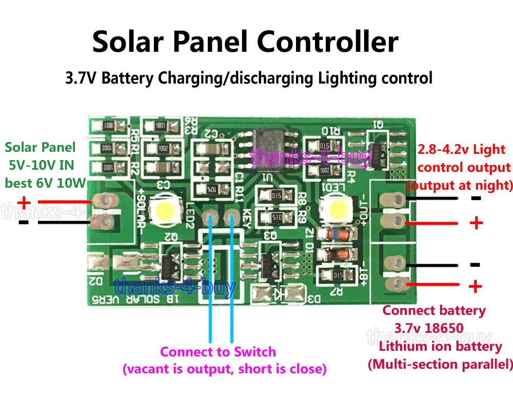

The common variety of solar garden lights use a dedicated four pin IC to manage operation.
Is there a similar single IC for garden lights that use a lithium cell ? Or modifying one to handle a 5V panel and a lithium cell ?

A solar garden light feeds about 10mA into a 3V LED for 8 hours. A 2V solar panel and 1.2V/300mAh AAA rechargeable cell is usually used with an IC that boosts the 1.2V battery voltage to 3V.
An 18650 cell averages 3.7V and has a capacity of about 3000mAh so it would power the solar garden light for 8 nights brightly before needing a recharge, or it will power 8 LEDs brightly each night.
I have one solar garden light that has a 3.5V solar panel and has a 3.3V/400mAh Li-Fe-O4 cell the size of an AAA cell. It charges all day and lights one white LED brightly all night. It uses a standard 5252F IC that is used in normal solar garden lights that use an inductor to boost the 1.2V battery voltage but doesn't need an inductor to boost the voltage, instead it has a current-limiting resistor in series with the LED. I guess the IC simply turns the LED on when it is dark.

Checked the 5252F data sheet and does not show useable with lithium cells... For a 5.0V weak panel perhaps after a diode...
Such chip is to boost 1.2V to the LED Vf. A chip fed by 3.x to 4.2V from single lithium cell would not be needed.
Still after a circuit or IC that will safely charge to 4.1 - 4.2V at daylight and turn a non-LED device on when dark.

Thanks, Audioguru. I will then investigate further to find an application note for the 5252F as you mentioned, without the inductor. Or will have to buy one and check how is it wired.
Seems like without the inductor, that IC will only work as light sensing and turning the load on at dark, the boosting section inoperative. Which is OK.
Found this cheap board/kit with no schematic... seems meant to light a LED, not another kind of load as am after. Perhaps jumpering the load series resistor would apply power to the load with no current limitation.
----> https://www.aliexpress.com/item/DIY...id=7c14da39-98be-4852-a906-08244f6e3559&tpp=1
Made the schematic observing the board...
Now, is there any chinese that can be believed ? Uses the S8050 transistor :
Now watch this : Both PNP and NPN
PNP ----> http://www.datasheet.hk/view_download.php?id=1025659&file=0001\s8050_4577.pdf
NPN ----> https://www.digchip.com/datasheets/parts/datasheet/284/S8050-pdf.php
