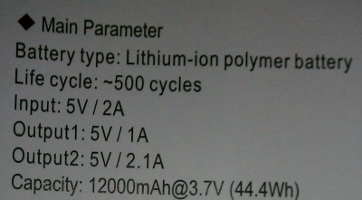

Product A: New Trent iCarrier 12000mAh battery pack
Dimensions: 2.9 x 2.8 x 1.1 inches, weight unknown
Product B: Anker® Astro3 10000mAh
Dimensions: 4.9 x 2.9 x 0.9 inches ; 9.9 ounces
I'm guessing most people wouldnt really care one way or another, but Im curious what they might have done to in this year's Product A to make it a bit more space efficient.

Not to mention there is no official standard at which batteries are measured... So in reality the numbers are pretty useless... One battery company might measure the drain time with a 1mA load while another might measure it with a 10mA load, others will aim for a set discharge time and reverse factor the load based on that time and then just like any less then honest company they will pad the results in their favor based on the best results they could get out of multiple test in a laboratory environment...
There are a few websites that are devoted to testing lipo battery packs and the real world results vs the stated ones are ALL over the board, some close some not even in the ballpark... You will also find the cells you purchase today from company A might not be the same cells you get next week if you reorder... And since 99% of the packs come from China where all the lithium comes from you can't simply state the Chinese ones are the bad ones and the blah blah are the good ones, it's not that simple...
In the end take the measurement with a grain of salt, especially if there is no documented datasheet from the battery manufacture graphing the test results... You will generally only see these charts from the big name brands like Energizer and Duracell...
As for the size my phone has a 'verified' 1500 mAH battery that is 1.75 x 2.55 x 0.22 (aka 0.98 cubic inches, it actually has a little spacer block so the battery itself is a bit smaller) take those numbers and it very possible to get a 12000 mAH battery in the 8.932 cubic inch space you have indicated...
(8.932 / 0.98) * 1500 = 13,671

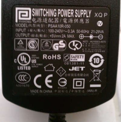

Coca-Cola or anyone, could you please tell me which Output plug would be most appropriate for my Wireless USB Transmitter (based on it's original AC wall adapter)?
I can't remember which plug I plugged it into, I "think" I put it in Output 1. I really worried I might have reduced the life of my Wireless USB Transmitter. *How serious is it if I had put it in the wrong Output?
Anyway, I would like to know which Output 1 or Output 2 is ideal for my Wireless USB Transmitter (based on what it says on the original AC wall power adapter that came with the USB Transmitter:
Here's a picture of the original AC wall adapter:
I can't stop stressing out that I might have somehow caused unnecessary stress or wear on my USB wireless transmitter by possibly using the wrong Output plug.

Either one will work just fine for your USB standard device, as the USB standard only officially supports current drains up to about 1A... So any compliant USB device should use less then 1A... The higher rated output is for things like new phones, that have detection circuitry in them... If they detect a 'real' USB port they will only draw the maximum current within USB specs, basically they throttle down the charge rate... If they detect a charger circuit they will draw more current so they charge faster...
