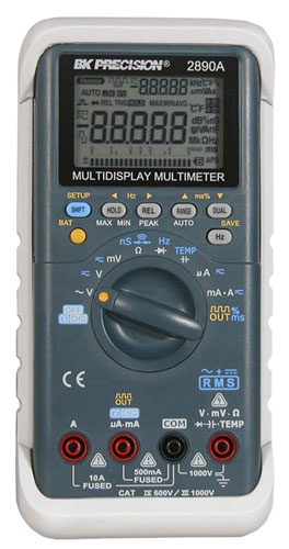

You make a lot of assumptions and generalizations about the way digital multimeter bar-graph displays work in conjunction with their 7-segment digital displays. I use a (now discontinued) B&K Precision Model 2890A digital multimeter with a 00000 to 51000 count 7-segment display, and below that a 20-bar display that reads from 0 to 5. I have not seen any perceptible difference in the update rates of the two displays. The bar-graph very easily shows "trends" much in the same manner as an analog D'Arsonval meter display, but without any meter "dampening" effect which I sometimes wish it had. Clearly the bar-graph full-scale display resolution is only slightly greater than one significant digit: 0, 0.25, 0.50, 0.75, 1.0, 1.25, 1.50 ... 4.75, 5.0. My eye usually ignores the intermediate bar-graph "values" and quickly "estimates" the deviation from the "cardinal" values of 0, 1, 2, 3, 4, and 5.
My question here is, how would it be possible to make any one part of a LCD refresh faster than all the other parts?
The LCD display has independently addressable sections. How else to distinguish between meter functions and polarity of DC inputs? It is a matter of programming how often any given part of the LCD display is refreshed. Inexpensive multimeters may not have as many display elements as, say, my multimeter, but surely they have at least a polarity indicator and an over-range indicator that are separately addressed from the 7-segment digital display.

Yeah, me too. A logic probe and an oscilloscope are my "go to" tools for that sort of thing. The multimeter is mainly for verifying I remembered to turn the DC power supply on and have connected it to the circuitry. I actually prefer my analog Triplett VOM for continuity measurements because (1) my hearing is not so good anymore so it is difficult to hear the high-pitched continuity "beeeep" from my digital multimeter and (2) I can see the meter pointer move and get a quick "eye ball" estimate of the resistance from a fair distance away.
As far as LCD update rates are concerned... LCDs in the past were notoriously slow to respond because of the physical properties of the twisted nematic crystal's response to an applied bias field. This has been much improved over the past forty years or so, to the point where my eyes don't see any delay at all in the rate at which both the bar graph and the five seven-segment digits update on my multimeter. Once you get past a certain speed of response, it is impossible to observe, and irrelevant to consider, what needs to slow down to make the display work. After all, television sets now commonly use LCD pixels and those turn on and off very quickly. As in all time-division multiplexed schemes, everything needs its own time slot, but some things can get more time slots than others for any given refresh interval. It's a Human-Machine-Interface (HMI) design consideration, so feel free to design your own version.
