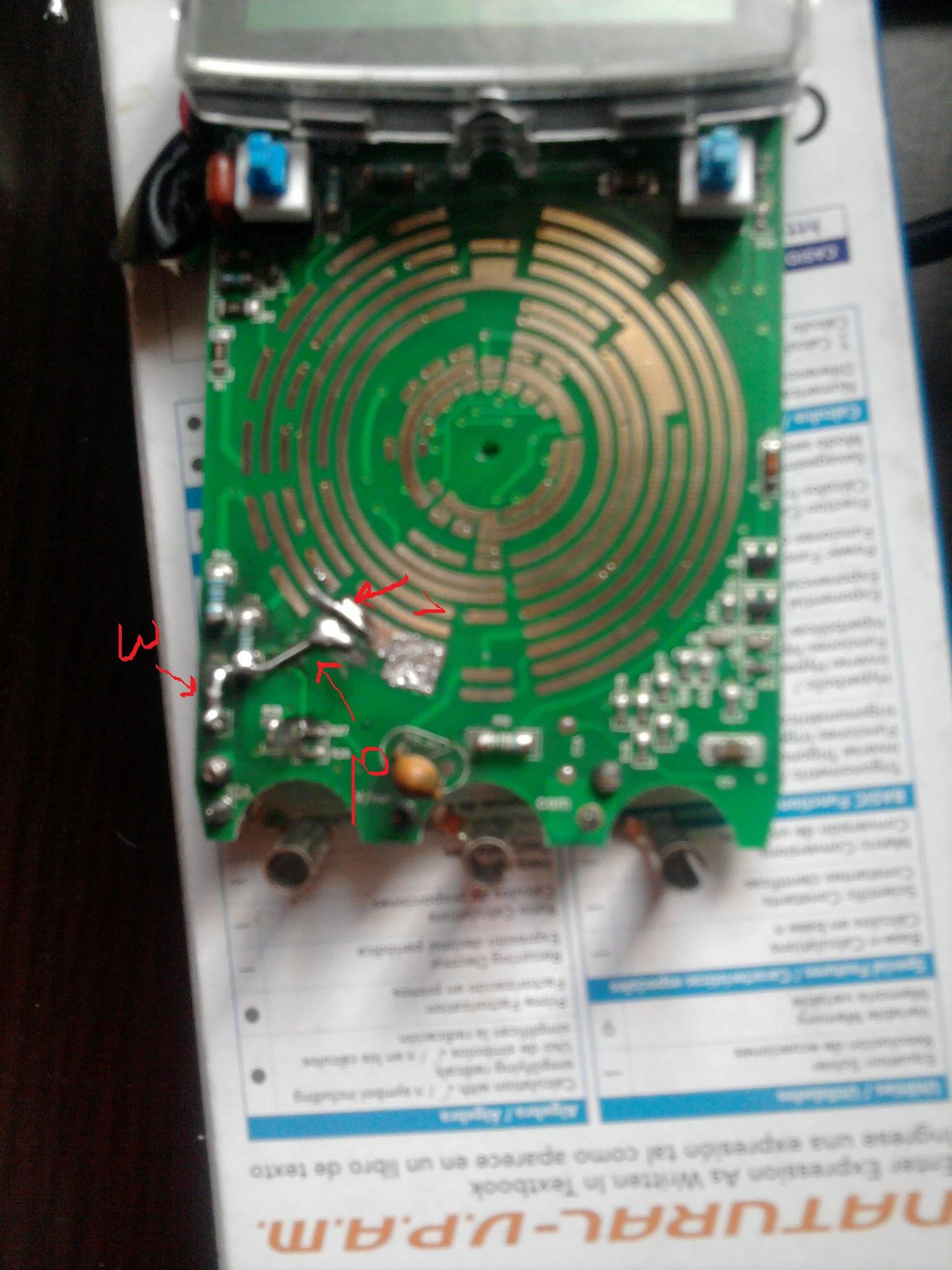

For the DMM ( Uni-trend UT33C ) i have noticed a burn in the motherboard , replaced a resistance about 9 ohms with a jumper , fixed the burned switch crossing paths , but i have a -1 in almost any selection , am wandering if it could be from the jumper i made :confused:.

show us a photo of the repair you made to the DMM

Ok hre is the picture with arrows
arrow 1 indicates the fixed path
arrow 2 indicates the burned path that goes to the resistance
arrow 3 indicates the jumper i did as a replacement for the 9 ohm resistance

The roundabout looks like a gold plated switch pattern and will be mated with a dozen wipers.
You have put blobs of solder on this - bad news.

Even with blobs the switch goes very well on the paths , the problem is that negative -1 i get , could it be from the micro-controller ?
Its not gold lol , its just the reflection of light that gives it that color

Regardless of whether or not it's gold, it IS plated, and that's what duke is trying to tell you. The tracks are very thin, and when you put a blob of solder on the track it forces the wiper up and may well damage the wiper's contact surface over time. So he was warning you that your repair is not a good one, and may well end up taking your switch out over time.

and its probably at least one of the reasons that the meter isn't reading correctly
you really cannot get away with rough repairs like that. its just making a mess of things

In the short term, I would guess that whatever vaporized the tracks also damaged something else in the meter.

no not really ... cheaper to buy a replacement meter.
