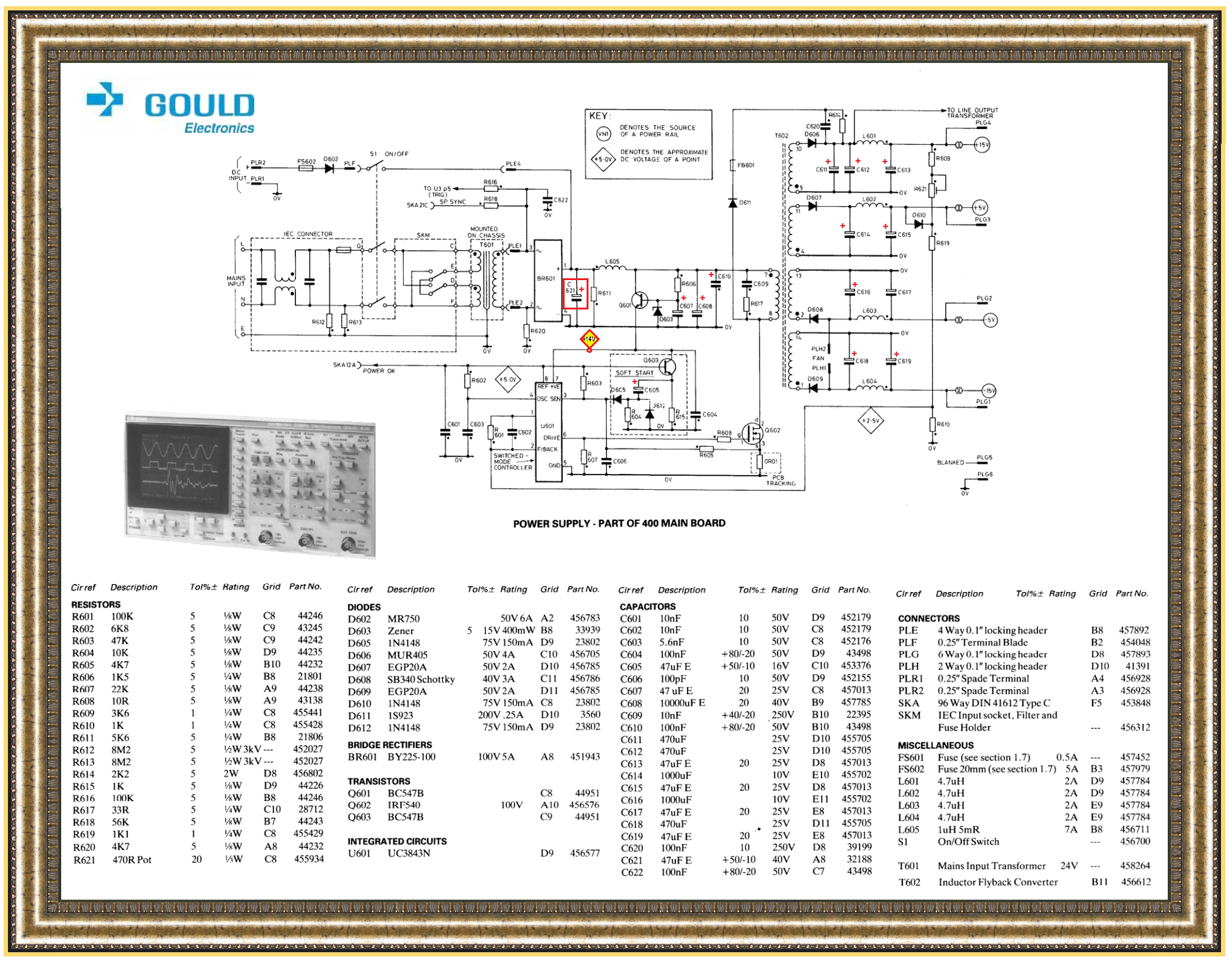

I have a Gould 465 DSO, 100 MHz. It was running fine when I left for lunch, but when I got back, the only thing running on the front panel was the power button indicator. Am I likely looking at the bridge rectifier having failed? The power supply has only one fuse that I can see and it tests ok. I've got it pretty well stripped down and I don't see/smell anything that would indicate a failed component. If there is a hidden fuse somewhere, that would be the next thing I'd check. It is completely dead except for that front panel light for the power button.

Sir fmevanspe . . . . .
Why...why...why...and thats HEAVY on the why's . . . .are you being so fixated on the units bridge rectifier.
' Considerating ' . . .that the MAJORITY of those failures are related to junctions shorting . . .the adjunct fiter capacitors would not be happy at all, and PROTEST accordingly.
Now lets see if the same power supply was used in all of the GOULD 400 series.
Consult the supplied schema below and see if you have upwards of 24VDC being present
at the first filter served by that rectifier . . .as . . .C621.
Then see if the reduced ~14VDC supply is coming off the emitter of regulator Q601.
If so, the switch mode supply might actually be operating, so move on over to the outputted supply voltages and read across the cathode of D606 and across to the ground of the C611 first filter cap.
Standing by for your results . . . . . and / any / or further how do I done did dat ? related queries.
RELATED POWER SUPPLY SCHEMATIC . . . . .

I'm not fixated on the bridge rectifier...if the fuse had been blown, I would have immediately suspected a shorted capacitor.
I have a model 465, not a 400/420/450. The schematic I have is for the 400 series.
I did a more detailed components check in the power supply section. I found several caps that looked like they were leaking, so I removed them. They all tested ok with a Simpson 260 VOM. That doesn't accurately check the series resistance, but it would show a dead short.
When I pulled the three caps, the goo had literally eaten away the copper circuit foil and actually eroded the board itself! I don't see two of the three capacitors (C726 - 470uF/25V, and C729 - 1000uF/35V) on the 400 series schematics. I would like to have a schematic before I bridge the eroded copper traces. I am fairly sure that what is eroded was originally copper, but I'd prefer to be certain.
