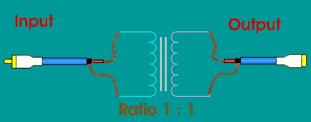

I was wondering if i could get away with an iron core toroid have 2 windings inplace of an audio transformer...
And if it's a 1:1 ratio what's increasing the number of turns going to do? Efficacy? Power waste?

2 turns would be much to low impedance at audio frequencies. I don't know how many would be correct, but it would be a lot more than 2.

2 turns? I said 2 windings (primary/secondary) ... i don't know how many turns that's what i'm asking hoping some audio experts could answer...

But basically the title says it all, for 5 bucks i can get two small transformers but as always i like to see if i can build a crude version as proof of concept, other than higher impedance the more turns i'm not sure how it affects audio quality does it remove more rfi/hum the more turns of equal ratio...
They're pretty simple circuits of just a transformer for each channel but just what would be the difference between 500 turns vs 50,000 turns 1:1 less hiss? But less volume/db? Is it acting as an inductor ?
When learning i knew my area of interest was low voltage dc (i'm a programmer primarily) so other than learning about transformers and a little here and there if i could use a solid state option i do...
But sound has me fascinated and removing the AC mains hum i thought i'd buy a ground loop filter but i was wondering what kind of results i'd get if i did my own using s torroid rather than the typical audio transformer..

Most include an extra capacitor.... but question remains is there a rule for turns on a ground loop filter?

I am probably out of my level of expertise here, but I will try a quick calculation:
Basically, too few turns would look like a short on the input side of the transformer. Line level is nominally 600Ω impedance. You would want the impedance of the transformer to be around that high at the lowest frequencies required, which is 20Hz.
Using this inductance calculator:
https://www.easycalculation.com/physics/electromagnetism/inductive-reactance.php
I determine that it would take 0.5H of inductance to make the reactance 600Ω at 20Hz
Then, using this calculator:
http://www.66pacific.com/calculators/toroid_calc.aspx
I get that on an FT114 core (a little over 1 inch outer diameter) this would require about 1000 turns.
