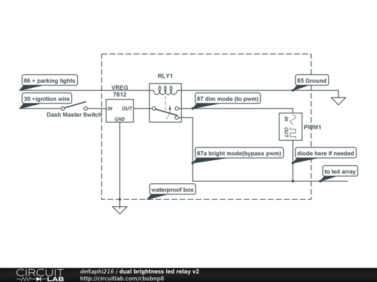

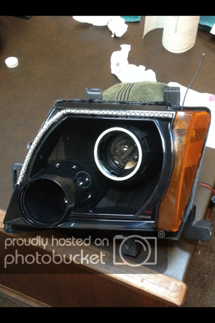

I did something similar to my xterra, I did a retrofit and used a bi-xenon projector and built my own custom DRL strip. The problem was that the DRL strip was soo bright at night so when my actual driving lights came on I needed to dim the Cree LED DRL strip. So how I did it was use a relay and PWM to turn them on and off when my driving lights came on. The relay was turned on when the driving lights were turned on so then the PWN turned on... thus dimming the overly bright DRL strip. Hope this can help you out
Here was how it worked.
Curtesy Deltaphi216
The strip that looks like a backwards 7 with an arch in it was the one I built, the halos were just aftermarket.

Thanks for the replies! That schematic will definitely be useful.
Any ideas on what circuit I could use to trigger different functions based on the voltage? Basically the state of the low beam headlight bulb is what controls the DRL as well as the HID bulb.
  • 0v - No DRL, no HID
  • 6v - DRL on, HID off
  • 12v - DRL on but dimmed, HID on
