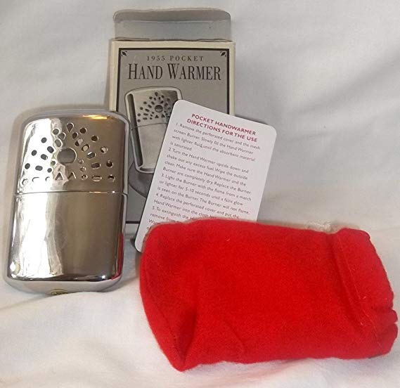

^ Might not be too bad if it was cold outside and in a garment worn over other clothing.
Besides the number is a bit meaningless without knowing the ambient temperature when the temp was taken so it could be seen as a rise over ambient temp, #.
Back in the day people used to use lighter fluid powered hand warmers in a felt pouch and they got at least that hot.
