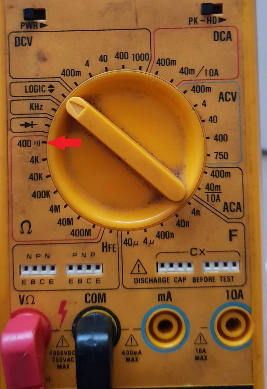

I have a rather old multimeter. I've attached a photo. I am diagnosing an issue with my car. The user guide says to remove the fuse and measure resistance between the terminals and it asks:
Is the resistance vale 1 Ω ± 1 Ω?
Can anyone kindly guide me through how I can use my multimeter to answer that question? I'm not sure why both values are 1 ?

It asks to measure the resistance that is any where between 0Ω and 2Ω. That's 1Ω PLUS (or MINUS) 1 ohm.
On your particular meter you would use the 400cCC range, short the two probes together and see if the display shows '0' - it probably won't but that's not a problem. Whatever your meter shows, you need to test and measure according to the instructions and the reading should lie 1Ω either side of whatever your meter shows when the probes are shorted together.
If your meter shows '5' when the probes are shorted then look for anything between 4 and 6 (most likely the higher number).
Since your meter has a continuity function you will hear a beep as you do this. If you hear a beep when measuring across the fuse then the fuse is ok.

by 400cCC do you mean like the one I illustrated in the following pic? and also, do I keep the probes connected as they are currently?

I am suspecting this is worded awkwardly and the test is just across the fuse blades to check whether it is blown instead of the instructions reading "continuity test it". The 400 Ohm setting, with speaker icon next to it which should indicate it's continuity mode, would do that.
However many fuses have an opening in the back that exposes contacts on both ends of the active fused element in the fuse body, so you don't even need to pull them out. If the circuit is supposed to be live you can just put one meter probe on any chassis ground point and the other meter probe on both sides (on either side, one after the other in turn) of the fuse through those openings on top. It should read around 12.6V on both sides.
If only one side reads that, the fuse is blown. If you don't get voltage on either side, the test is inconclusive, then you only know the circuit isn't live, not whether the fuse is good.
This also assumes your meter probes have tips small enough to fit in the fuse openings, and the fuse box is located where it's practical to do this instead of awkward and thus easier to just pull the fuse out.
