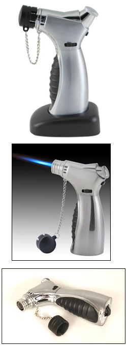

So ... I purchased one of these:
at bugstores.com for not much coin. Basically a miniature butane blowtorch. Creates a very fine, directed heat. A one second swipe across the harness, then a gentle pull, and it easily came loose.
I'm going to deal with the 3 components that have gone bad, but after this, I'm switching vendors.
Thank you everyone. Case closed!

Dont use that torch, too hot. Hair dryer on high. More pictures,please.
