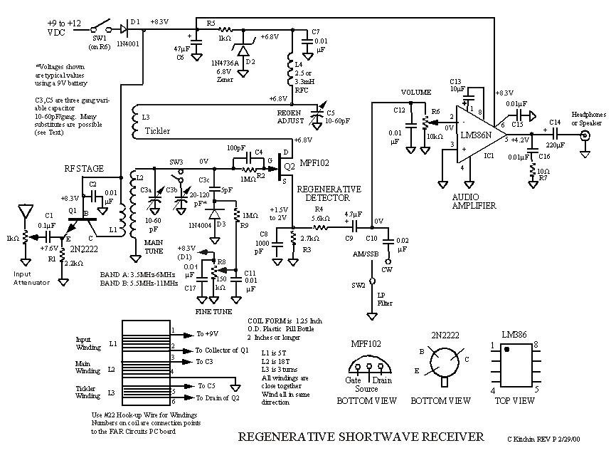

So this is the ground wire I am talking aout in these images I found on Google.
So after looking at his image I found on Google of a regenerative receiver, I see that that is not the place to connect the antenna, and the antenna should be connected to a piece of aluminum foil layed across the pickup contacts and the aluminum foil should be connected to the ground wire.
So then after looking at that image of the regenerative receiver, I see that it can receive AM not just morse code when it is not over driven to oscillation whining.
So then for the best results a separate audio gain stage should indeed be used in order to recieve more than morse code (right now I can only hear morse code). The separate audio gain stage is needed to amplify the audio output of the regenerative detector to be loud enough so the regenerative detector gain does not have to be over driven to oscillation whining.
After the first 26 words (in bold) the rest is all wrong.

That doesn't make any sense, because the regenerative detector that forms the feedback loop in the regenerative receiver is a triode tube or a simple PNP transistor that demodulates radio waves into audio at the same time as amplifying the audio thousands of times.
Do I really need the stupid "tickler coil" when I could just directly connect the connections to make the feedback loop instead of using induction?
And wouldn't the "tickler coil" make the receiver vulnerable to untuned radio interference bleeding in in the gap between the coils?

No, it is multiplying the RF, not the audio.

Wikipedia said:
Simple regenerative receivers lack an RF amplifier between the antenna and the regenerative detectors, so any change with the antenna swaying in the wind, etc. can change the frequency of the detector.
Okay, so the RF amp is not needed.
Wikipedia said:
Regenerative receivers require fewer components than other types of receiver circuit. The circuit's original attraction was that it got more amplification (gain) out of the expensive vacuum tubes of early receivers, thus requiring fewer stages of amplification. Early vacuum tubes had low gain at radio frequencies (RF). Therefore the TRF receivers used before regenerative receivers often required 5 or 6 tubes, each stage requiring tuned circuits that had to be tuned in tandem to bring in stations, making the receiver cumbersome, power hungry, and hard to adjust. Regenerative receivers, by contrast, could often get adequate gain with one tube. In the 1930s the regenerative receiver was replaced by the superheterodyne circuit in commercial receivers due to its superior performance and the falling cost of tubes. Transistors, either bipolar or JFETs are used in regenerative receivers today. In recent years the regenerative circuit has seen a modest comeback in receivers for low cost digital radio applications such as garage door openers, keyless locks, RFID readers, some cell phone receivers.
So I understand this part correctly as I talked about it before.
Wikipedia said:
Regeneration can increase the gain of an amplifier by a factor of 15,000 or more.
Cool. That's why I'm trying to build a regenerative receiver so I can use simple electronics components with only one gain stage before an audio amp, instead of having to amplify several stages in Audacity like I did to hear audible AM stations previously, so I can build a real radio instead of cheating using Audacity to amplify and clean up the garbage picked up by my guitar.
Wikipedia said:
A disadvantage of this receiver is that the regeneration (feedback) level must be adjusted when it is tuned to a new station. This is because the regenerative detector has less gain with stronger signals, and because the stronger signals cause the tube or transistor to operate on a different section of its amplification curve (i.e. grid V vs. plate V for tubes; gate V vs drain V for FET's, and base current vs. collector current for BJT's).
Yes, I have already discovered how difficult it is to tune to a station without having the mixer-detector oscillating infintely in a whine that hurts my ears.
When the regenerative detector is used in the self-oscillating mode, i.e. without a separate oscillator, it is known as an "autodyne".
So is this what I have built is not actually a regenerative receiver, but is actually an autodyne receiver that can only receive CW and cannot receive AM?
So is the correct location for the vari-cap to be inserted in the circuit do I want to put it actually in the feedback loop before demodulation instead of imediately after the antenna?
but how do I put a vari-cap in the feedback loop, when this would be completely useless for tuning since the mixer-detector demodulates so the vari-cap would only be acting as a tone control for audio demodulated?
So do I actually have the wrong type of transistor (audio mixer), and I should buy the correct transistor and then let the audio amp do the demodulating?

If you want to build a radio receiver you should leave your guitar and amp out of it. Look for circuits for radio receivers. If you get one that works and produces audio, you can run it through your guitar amp to get louder audio.
Bob
davenn
Sep 5, 2009
14,486
Sep 5, 2009
14,486
Bob
Agreed
most of this thread has been totally pointless and also has absolutely nothing to do with the thread title
