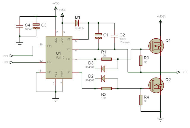

Thanks Minder, Can you please show me some diagram how to connect the resistor and the zener? Any 5volts zener will work? The input signal will be maybe 15volts at max, and I need to drive like 6 amp, I will like to use SMD components, any recomendation about a mosfet to drive at least 15volts and 6amp? I am using this projects in cars and motorbikes. Thanks again

This gives an idea what to use in the base of the Mosfet.
See Q2 ignore the rest..
D2 R2 R4.
M.

Minder, I just see that I need 15volts + from the Mosfet, I think that this will not work for me???

I using a μproc with a 5v out then a logic level mosfet is the easier choice.
