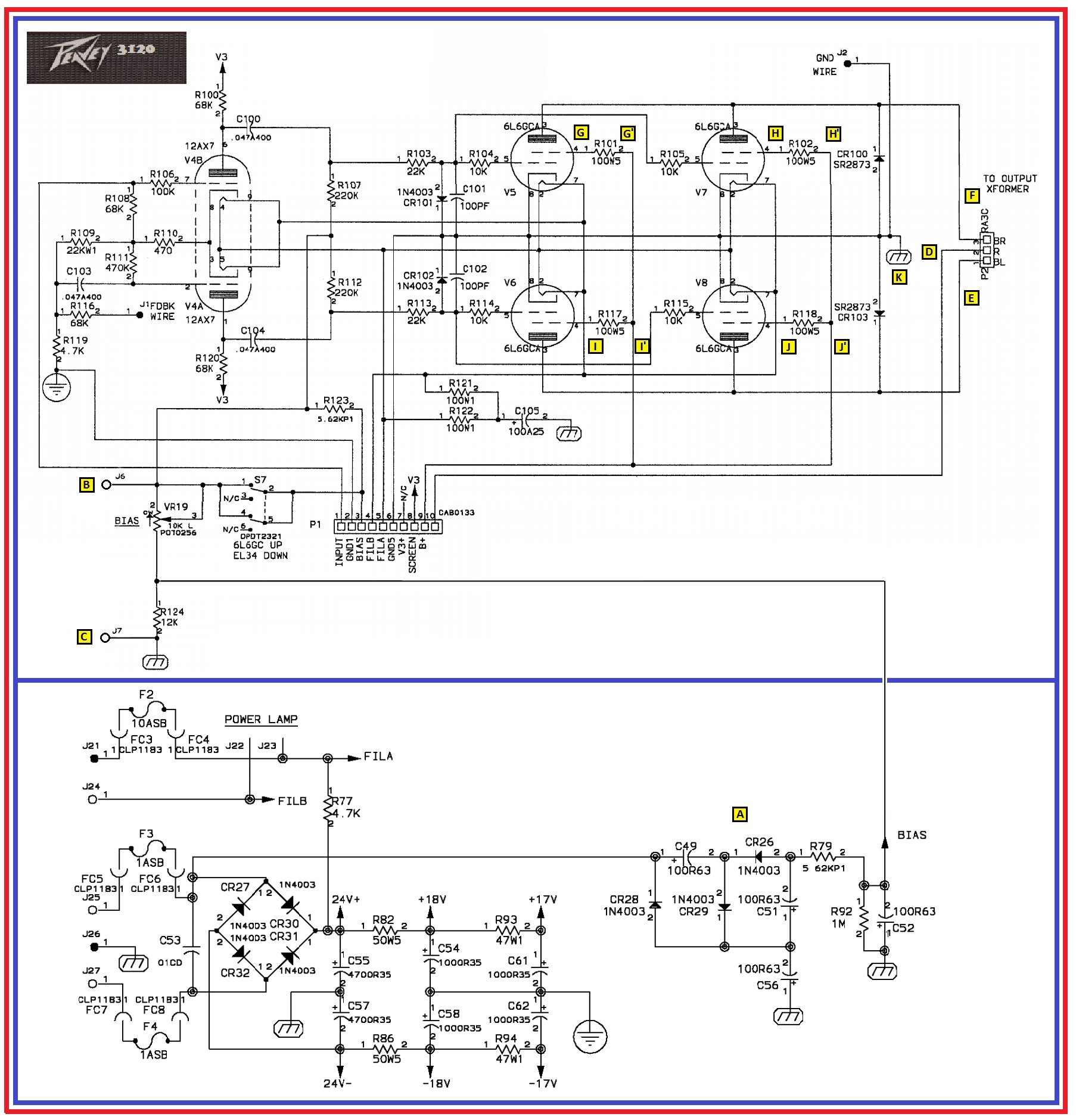

I'm trying to repair a guitar amp head, and it uses 4xEL34 matched pair power tubes for a total output of 120W and 4x12AX7 pre-amps, now I've replaced all the tubes, and checked for bad solder joints, and even checked the power tubes bias, and heater voltages according to the schematic, and I still can't stop the power tubes from glowing a bright orange, and an increasing crackling sound from the speaker, the head is a Peavey 3120, I am unable to use an AF injector + oscilloscope as I can't keep the amp powered on to long, I don't want to explode the tubes, the longer it's powered on, the louder the crackling and brighter the tubes glow.
Visual inspections show no sign of burnt components, and quick testing of any diodes don't show anything open or short, resistors around the power tubes for bias, and input show no deviation from their resistance values, and a test of the output transformer shows no sign of shorting.
The output impedance is switchable from 4, 8 and 16 ohms, but the 2 outputs are parallel, and according to the manual, the cabinet speakers have to have a resistance load of 8 ohms min per speaker within the cabinet, with the amp switch to 4 ohms, but I later found out that the guitarist was using 2x4 ohm speakers, and using the equation for parallel resistance, the head should be switched to 2 ohms, but the head doesn't have a 2 ohm setting, and reverse parallel equation shows that if the head is switched to 4 ohm, then the cabinet speakers must be 8 ohms each.
The equation I used is:-
RTotal = 1/((1/R1)+(1/R2))
giving that R1 and R2 both equal 4ohms, resulting in RTotal = 2ohms
In theory the mismatched impedance between speaker load and head output could have done something to the power output stage(s), but I'm stuck as to what.
I have exhausted everything I can think of and test, maybe someone can think of something I haven't.

what specifically is glowing bright orange ? .... the plates or the filaments ?
can you please post a schematic or a link to one

Sir usalabs . . . .
( Not Brittania-labs ? )
This sounds like a classic case of output tube grid mis-biasitis.
Let's use my markup test points for making some initial evaluations .
Have proper speakers… hooked up to the proper terminals on the amplifier and then use minimum volume setting,
Unless bringing up slightly, just to listen for the errant popping noise.
As soon as the tubes filaments warm up, take note of and initially log the negative voltage level being read between reference points B and C .
Expecting it to be at the negative 40 V range, but advance its control on up to max in order to see how much of a negative voltage swing is being possible. Log down that maximum voltage also .
Then bring it back down to a negative 42 volt setting.
My A reference is merely pointing out that the bias supply on this unit is being derived from voltage multipliers
with associated electrolytic capacitors. This old pup is getting on up into the 15 year age region . . . but . . .who am I to talk . . ..
See if those output tubes are not running cooler now.
If so confirmed, that will now let us move to some other points and take readings.
Main B+ reading from D needed, using K ground referencing . . .log.
Plate voltage readings of F and E needed, using K ground referencing . . .log.
Measure the voltage across each of the 100 ohm resistor at G-H-I-J and G'-H'-I'-J' . . .log.
Move back to the BC bias point and recheck the bias that was set ands see if there has been any voltage variance,
THEN you hold that reading and unplug that V4 12AX7 tube which feeds the output tubes.
Did that bias voltage then decline any ?.
IF there had ever been any random popping . . .did it stop when the 12AX7 was unplugged ?
Plug the 12AX7 back in.
Lastly do a smart finger thump to each output tube, to see if any internal flashover occurs.
Last info is acquired in no power condition, where you switch to ohmmeter mode and move back to D:
Measure the resistance from D to F . . . .log.
Measure the resistance from D to E . . . .log.

The plates glow orange. I'll explain the steps that lead to the orange glows.
1........turn on the standby switch
2........Power on the head (amp head is a description for the actual amp that uses separate cabinets for the speakers, whereas a combo would be the amp and speakers built into one unit)
3........Wait about 15 to 30s for quick warm-up
4.........switch off standby, and as soon as the standby switch is toggles to off, the 4 EL34's start a small blueish glow at the bottom near the heater filaments, then the plates start glowing orange and the longer the unit it powered on, the brighter the tubes glow and the louder the crackle, lowering the master and channel volumes have no affect, I did replace all the tubes though to make sure.

I can't do the steps you suggested [quote = 73's de Edd] Have proper speakers… hooked up to the proper terminals on the amplifier and then use minimum volume setting,[/quote] because the volume controls either the master or channel volumes have no affect on the steadily rising crackling, and it gets to a point that it's way to loud, but by then, those power tubes have got to a point that the orange is very bright, so I immediately power down the unit.
There is not enough time to keep the unit powered on while testing the circuits.the only other way I can test the circuits is with the 4xEL34's removed, but removing the tubes would alter the outcome of the tests, and the data spec for the amp show the voltages and currents while the amp is under load and the tubes are working to spec.

Sir usalabs . . . . .
OK . . . .then, try this, set up to INITIALLY monitor the voltage between B and C and then LOG the negative
voltage being present there.
Rapidly advance the bias pot to ascertain the max available bias and bring it back down to negative 45 if
you are tubed up with EL34's as outputs.
All of this should easily be possible before the tube filaments have even brought the tubes up to operating
temperatures.
Then . . . see if the " cherry plate syndrome " is still being existant.
If not, we more closely investigate C100 and C 104.
73's de Edd

This amplifier design has had an evolutionary transition in the output tubes that it uses.
It started with an option of either using the metal clad 6L6 or curvy 6L6 .
That then stepped up to the use of the straight side 6L6 GB.
Then the upgrade to the 6L6 GC . . . .or its industrial . . . . .5881.
Prepare for the British invasion with the influx of the KT66.
Finally the 6CA7---EL-34 utilization.
Note that there is an S7 switch for rough transitioning between the two tube families.
Each family requires a slightly different 1st grid biasing level.
That is why I requested the other readings, nothing beats computing the actual quiescent
current of the output tubes, and setting it up.
Re: B+ power supply schematic . . . .omitted . . . .due to the sizeable area already present on the page.

The amp uses 4xEL34's as box standard and can use the 6L6's, I believe the 6L6's are 60W a pair, whereas the EL34's are only 50W a pair.
I have the same schematic 73's de Edd posted.
Regarding the output transformer, seeing as I can not get the exact manufactures technical details for that amp, such as tube characteristics and data, and transformer specs, I can't say by testing the windings of the output transformer, that the tests correspond with the manufacture details, but a continuity test didn't show an open circuit, the test was performed with the transformer on the bench.

Sir usalabs . . . .
Third reply . . .
With something that you positively should relate to:
If you don't breathe . . .you die . . .PDQ.
Since those EL34's cathodes are direct to ground . . . . thereby with zero possibility of self biasing.
If they don't have -45 volts grid biasing being provided at their 1st grids . . .they die also . . .PDQ.
(Which you already are evidencing the onset of . . . .as they presently are.)
Sooooooooo get back to them and get -45 1st grid bias on them . . . . .and then see if things don't cool down.
My questioning of the DC resistance of the output transformer was NOT being relevant to any open connection, but to be used in monitoring the actual quiescent current of the EL34 output tubes later, in their proper bias set ups adjustment.
73' de Edd
