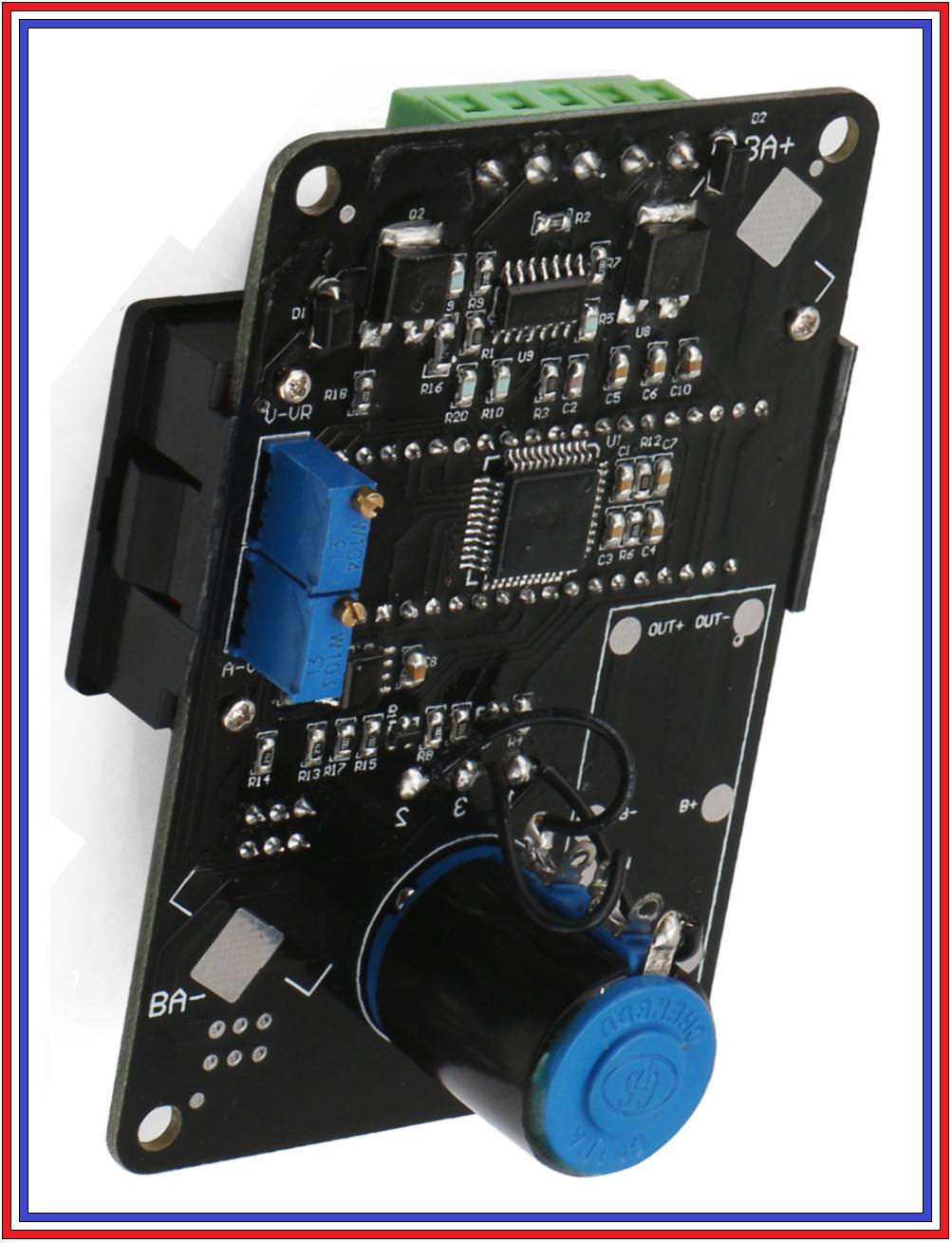

Sir edennis . . . . .
One oddity there, is the presence of . . . . almost . . . .full voltage, (9.08) with the control pot being at only half position . What is the voltage swing, when you vary the pot between its extreme limits ?
Got the on off switch now, seems like it is an option . . . with it being a DPDT switch . . .to switch both power legs, and that you have to cut open internal PCB foil links IF you have it installed.
Looks like I'm now answering myself on the pots knob position . . .in my expecting a conventional 270 degree rotation
Not so . . .in this case . . . in its using a 10 turn helipot, so it changes and passes thru many mid positions.
Looks like they were set up for bottom / in case battery installation also.
Still need to know the full voltage swing output and if its current speed range seems to fulfill your needs . . as per MINDER.
Seems like 50% speed on up to max would be what is needed, with nothing lower.
If that does prove to be true, it is possible to alter that present dead area on either end of the adjustment of the pot.
Then. . . . it would have the pot starting at the slowest speed and using the full 10 turns to then ramp progressively on up to the full top speed.
Looking at the PCB proper . . .at least 90% of the degree of complexity being seen is related to metering.
That leaves the area in the immediate area of the BLUE pot and the upper U9 and Q2 quadrant for the principal variable voltage and 20 ma current loop aspects.
The solo U8 3 term regulator in the top right corner, and no FWB or adjunct filterings, relate to only accomodating a filtered DC power input.
