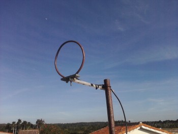

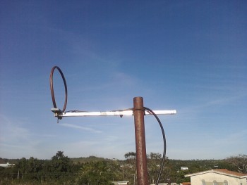

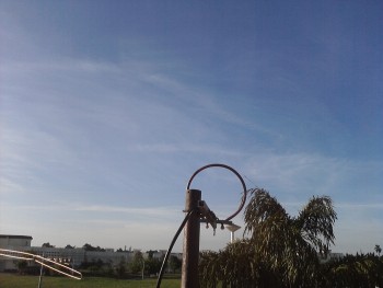

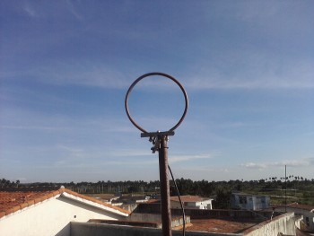

Hello everybody. Hope all of you had had a nice time last week. Happy new year for everybody!!!
Well, the antenna worked!!! I built a 25cm round loop and positioned on the roof of my sister house. The antenna is for my sister as I have not acquire the digital decoder yet :(. The reception is very good. No more pixelation of the image till now.

Great to see the hurricane-proof version. Congratulations !

Miguel Lopez
Jan 25, 2012
255
Jan 25, 2012
255
Pictures are in Post #6. I have not made any change in the aerial until know what to do first. I want to make changes as with the original design (the one in the pictures) I have noticed that signal level in the TV set has decreased. That's why I want to make changes to increase gain.
davenn
Sep 5, 2009
14,487
Sep 5, 2009
14,487
OK when you had said you will try, I was assuming you were going to try the 3 element style for higher gain
but those pics in post #6 don't show the feedpoint detail
As I said earlier .... for receive antennas, dimensions are not wildly critical
make the reflector loop 10% larger and the director loop 10% smaller than the driven element
place the reflector and director loops around 1/2 wavelength (of the freq you are interested in)
behind and in front of the driven element ( the one with the coax feed). you can experiment with
varying the distance between the driven element and the director loops
Dave
