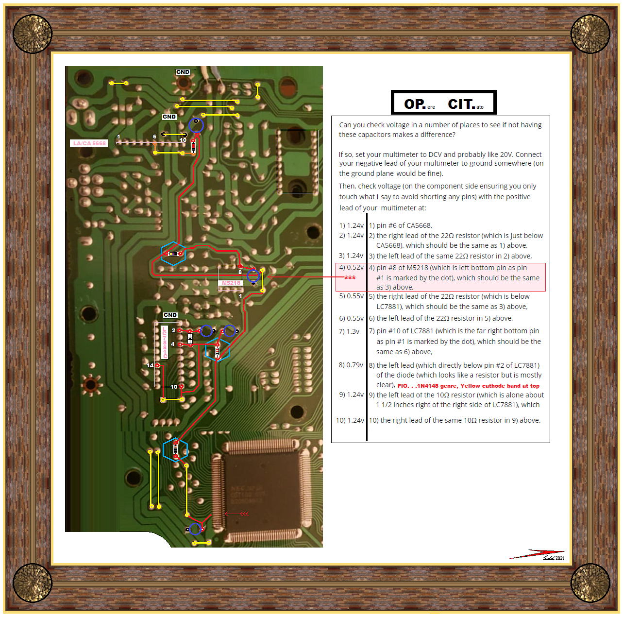

If you want to. It probably doesn't matter much, but if you wanted to re-measure some, just do these:
5) the right lead of the 22Ω resistor (which is below LC7881), which should be the same as 3) above,
6) the left lead of the 22Ω resistor in 5) above.
To ensure you are measuring the 22Ω resistor, this is the red-red-black one that is just below the row of C101 green capacitors and just to the right of the 2 electrolytic capacitors. My instruction were not all that clear when I read them again. Thanks.
yes you were right I did measure the wrong resistor. I measured the resistor that was just bellow pin 1 of LC7881 (which I have circled green in the attached photo)
When I measured the resistor that the yellow arrow points to I got
5) 1.24v
6)1.24v

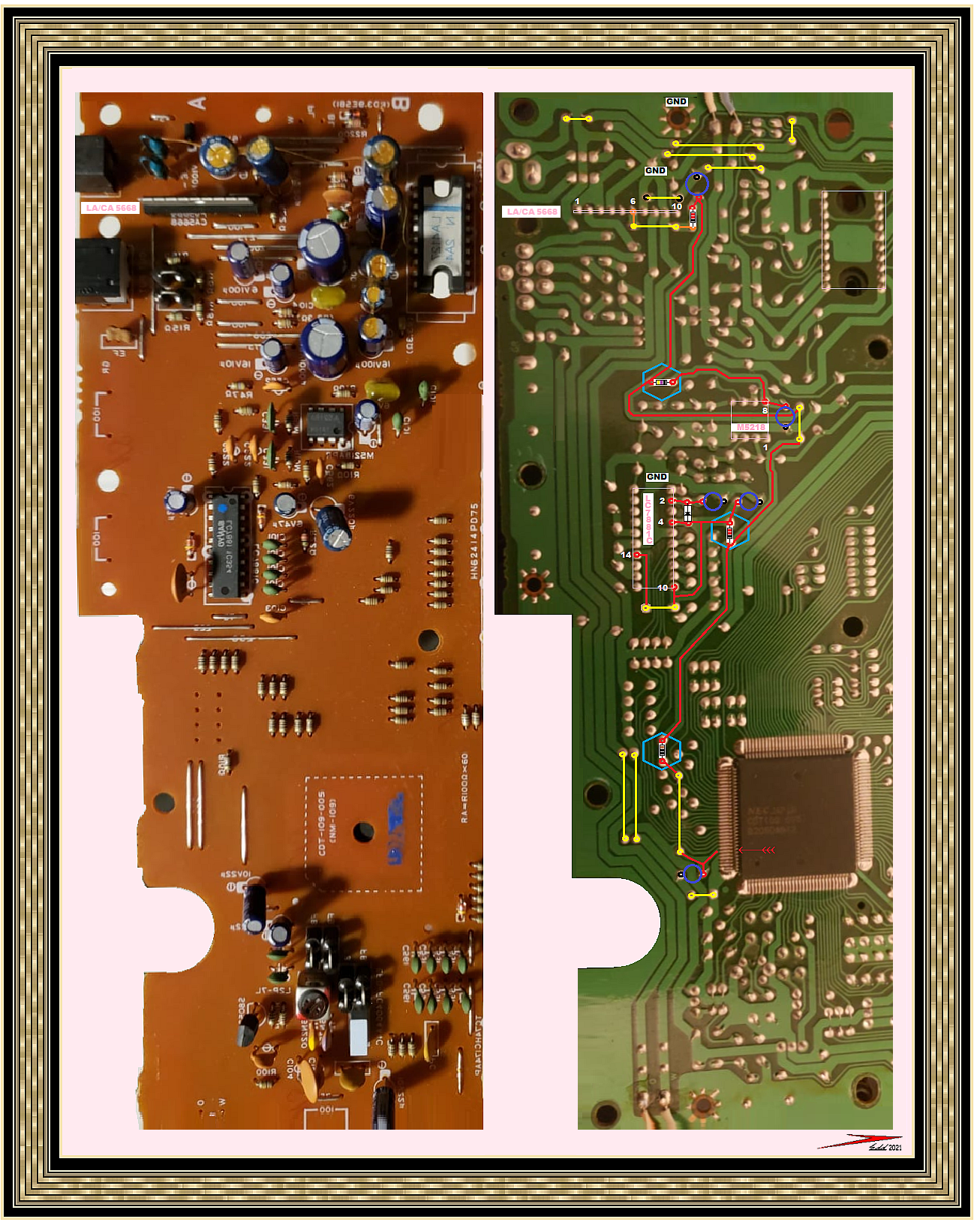

Sir LJ89 . . . . .
GAMES ON !
Now, just especially for you, is your . . . . . winning secrets . . . . . playbook . . . . .
Now . . .for us to find out . . . . . WHY the units AVDD +5 volt supply line is now being SO abysmally low ?
Is it because of excess power pull and loading of one of the 3 circuits served, or is it the AVDD +5 volt portion within the regulator IC, more in depth testing should reveal.
Using the markups of my REFERENCES right half , note the initial derivation of that supply from LA/CA5668's pin 6 and is initially being marked up with an ORANGE flow line, then it has to transition to a bare wire jumper as the YELLOW line, then it feeds into a 33 ohm (bands of red-red-black) resistor and then on that resistors other side, grabs some filtering and bypass decoupling, provided by the BLUE E-cap , being just physically above.. . to the top.
Those two parts junction and then flow straight down, to make a color flow line transition, to then being of a RED color coding.
The first circuit encounter will then be at the TURQOISE hexagonal marker to feed thru a 47 ohm (bands of yel-viol-black) resistor and then on that resistors other side, it grabs some filtering and bypass decoupling, being provided by the BLUE E-cap that is just physically to the right of pin 8 of the units M5218 I.C..
Now, going back to the RED supply line, since it then takes a very round about routing to ALSO then finally end up at about the almost same identical place and then has to use a YELLOW jumper wire to drop down and continue a RED downward path.
It then encounters a TURQOISE hexagonal marker to then feed thru a 33 ohm (bands of red-red-black) resistor, then the RED line on the other end of the resistor receives filtering and bypass decoupling, from the BLUE E-cap just physically above, and to the right.
The RED line also branches to the left to feed pin 4, then loops down to feed pin10 and uses a YELLOW jumper wire to then continue as a RED line and connect into pin 14.
A final connection is made from the RED line buss via a directional steering diode. One of its connection is just to the right of pin 4 then up and out into pin 2 . . . AND this junctilon also gets some filtering and bypass decoupling by a BLUE E-cap, with its + being connected into I.C.pin 2's right buss.
ALL ABOARD . . .LAST STOP ! . . .as the end of the line, is now coming up.
Follow the RED line down to the final TURQOISE hexagonal marker and its feeding off into a 10 ohm (bands of brown-black-black) *** resistor, then a short RED line flow path downward until another YELLOW wire jumper. *** ( Correct me on that resistor value, if being found different . . . .as it wuz, vewy-vewy hards to TRY to reeds ! )
Exit into a RED line until it makes a dual junction , one being into two pins of the u /Processor and another route into some filtering and bypass decoupling by the positive of a BLUE E-cap, down at the junctions bottom and with the E-caps grounding lead being on far left.

SELECT CIRCUIT REFERENCING . . . . .
https://i.ibb.co/vvZpFfx/Casio-5-AVDD-Supply-Power-Flow-Path.png

Sir 73's de Edd,
I have some preliminary results as per your request!
At the first blue hexagon I removed one lead of the 47ohm resistor. I checked the voltage at pin 6 of CA5668 and at where AVDD 5+ supply connects to the 22 ohm resistor. They both read 1.64 v
Than at the second blue hexagon I removed one lead of the 22ohm resistor. I checked the voltage at pin 6 of CA5668 and at where AVDD 5+ supply connects to the 22 ohm resistor. They both read 0 v.
I found this kind of odd... I could not turn on the keyboard at all (no red light for power) with wall wart or batteries... So I resoldered the floating pin of the 22ohm resistor back onto the PCB. And now the keyboard would turn on and I checked the voltage at pin 6 of CA5668 and at where AVDD 5+ supply connects to the 22 ohm resistor. They both read 1.64 v.
So I continued to the next hexagon and removed one pin of the 10ohm resistor. I checked the voltage at pin 6 of CA5668 and at where AVDD 5+ supply connects to the 22 ohm resistor. They both read 1.8 v.
I tried pressing some buttons and you could hear some very staticky, garbled, tones that you can hear without putting your ear to the speakers.
So at this point I have one lead of the first hexagon 47ohm resistor floating and one lead of the third hexagon 10ohm resistor floating. The second hexagon 22ohm resistor is resoldered to the board.
Let me know what you think doctor.
Should I just go ahead with the other tests you requested in your post, regarding setting my meter to OHMS. let me know!

Sires LJ89 et vbplayer . . . . . .
There is an increasing crescendo of voicing coming upwards from your board, in the *** RED arrow designated sector shouting
. . . . it's me . . . . . . IT"S ME . . . . . *** IT"S ME ! ***
And one of the two likely options, is being the M5218 I.C., BUT, just HOPE that its being that circuits associated E-cap . . . . dead shorted.
With all of your researched voltages to the different stages . . . as compiled in the ref below . . . .initially, in a no power applied state, do an ohms test by
using + probe to that stages E--cap + and the meters black ground lead to star ground.
If shorted, pull it off the board and you might then reconnect any disconnected feeder resistors, so that you can then power up the unit again to retest the AVDD 5+ supply line and confirm that it is now staying up to a +5' ish volt level now, with power getting to all sections..
Woe is you ! . . .SHOULD IT THEN HAPPEN TO BE THE UNITS M5218 I.C. . . instead.
USE THIS PROCEDURE TO PULL THAT M5218 I. C., OFF THE BOARD . . . . .

Cool. So those measurements make much more sense (i.e. what I would have expected with the 1.24V showing up @ pin #6 of CA5668).
As for your finger touching both the first resistor and pin #1 of LC7881, not sure what happened here. It is a good sign of life after death though. Pin #1 is one of the outputs of LC7881 (most likely the Left channel) and pin #20 is the other output (most likely the Right channel). If your finger contacted pin #1 and the resistor lead closest to that pin, I don't think anything should have happened as pin #1 should be connected to this resistor lead by a trace. And likewise, if your finger contacted pin #1 and the resistor lead farthest from that pin, I don't think anything should have happened here because from your previous measurements on each side of that resistor (i.e. 0.55V from Post #71), no current is flowing through this resistor. Perhaps somehow you created some kind of short against some other contact that caused the sound clip. Maybe 73's de Edd could chime in on this encounter with a more enlightening explanation.

We have some numbers here for you Sir. I tested the capacitor to the right of m5218 with the diode tester on my multi meter. it charged up to 1.18 V and did not go any furthur.... (see picture below)
So than I desoldered it and tested it off the board and it went up to just before 3v and than it read OL. (see picture below)
I went to read the voltage of PIN6 of CA5668 and it read 1.7 V
so than I desoldered pin 8 of m5218 and I confirmed it was floating by doing a continuity test with the positive hole of that capacitor I just took off, and I confirmed that it was not touching the holes walls...
So than I measured voltage at pin 6 of CA5668 and it read 1.7 V .
no music noted.
Let me know what you think of if i've missed anything.
I did resolder the 2 remaining resistors. and currently there are 3 capacitors off the board. and pin 8 of M5218 is floating.
Should I resolder anything back just yet?
one of the pictures ive attached has a blue arrow going to where I took the capacitor off. and a red arrow going to the floating pin 8 of m5218.

Excellent job of testing things. I would not resolder the capacitors yet (will explain below).
Here are some observations:
a) you removed the correct capacitor (next to M5218),
b) you desoldered pin #8 on M5218 well (although I see little flakes of solder in places around the area from your picture),
c) you have a Klein Tools MM600 multimeter (which has a capacitance reading capability),
d) obviously, 1.7V wasn't the DC measurement we were hoping for on pin #6 of CA5668 (this pretty much matches what you were reading in Post #82), and
e) I am confused by your last statement in Post #90 that "The voltage of my LC7881 is 0 V after floating pin8 of M5218". That makes no sense (unless there is some kind of short in that circuitry). Hhhhmmmm.
Here's what I would do at this point. But, if you would prefer to let 73's de Edd chime in first, I completely understand.
My suggestions:
1) Clean your PCB a bit in the areas where you have desoldered and resoldered components (i.e. 3 desoldered capacitors, 2 resoldered resistors, and pin #8 of M5218). If you have some rubbing alcohol, put a little on a clean rag (or Q-tips) and rub around the worked areas on the green side of the PCB. Don't scrub, just rub to remove any solder specks and flux residue being careful not to catch the rag or Q-tip threads on the protruding wire leads and pins. Then, let this dry (should be quick) and inspect very closely for solder flecks still on the PCB. To me, from your close-up picture with your red and blue arrows, it looks like there could be some potential solder bridges between some M5218 pins which might be bad. If you need to, use a toothpick (or something that won't scratch the PCB) to gently get rid of these solder flecks.
2) Retake the DC voltage measurement at pin #6 of CA5668 to see if it has changed from 1.7V. If it hasn't changed to around +5VDC, take some measurements (or all 12 except #4) I asked you to take before when going through the traces from CA5668 pin #6. Other than the initial 22Ω resistor just after pin #6 of CA5668, there shouldn't be any influence on the AVDD voltage until the trace gets to the circuitry associated with LC7881.
3) At this point, we need to first, ensure the CA5668 IC isn't damaged. Then, if the IC is OK, we need to isolate the the problem around LC7881 (and beyond). I recommend desoldering the wire jumper I discussed earlier in Post #78. You don't need to remove the whole jumper, but just desolder one end and carefully bend the end (don't lift trace) so it is "floating" in the hole (just like pin #8 of M5218). Do a continuity test to ensure this wire jumper end is "floating" (i.e. not contacting the trace). This will completely remove all LC7881 circuitry (and beyond) from the picture. After "floating" one end of the jumper, check pin #6 of CA5668 again (hopefully it will be around +5VDC). If it isn't around +5VDC, then either CA5668 is damaged, or there is still some path to ground (a short) somewhere. If it is around +5VDC, then the problem is around LC7881. I'll stop here to see where we need to go next based on your findings.
4) Since your multimeter has a capacitance reading capability, I would check the capacitance of each of the 3 electrolytic capacitors you have removed (since they are off the PCB). Again, you can ONLY accurately check capacitance when they are removed from the PBC (i.e. off-board, not in-circuit). Remember, before you test capacitance (as I have stated before), make sure you discharge the capacitor by shorting across it's leads (if you don't do this, you could damage your multimeter). Set your multimeter to the capacitance setting (i.e. -||- symbol). The actual capacitance symbol has the right vertical line arched a little, but I cannot represent that well with a "C" or "c" (look at your User's Guide for symbol on p. 6 and operation on p. 15). Let us know what the 3 capacitors measure.
That's it for now.

Hey,
1) I tried to clean the pcb as best i could using alcohol swabs, there was definitely some specks I lifted. I've attached some after pictures of the "clean pcb"
2) Here are my readings using battery power.
1) pin #6 of CA5668 = 1.7vdc
2) the right lead of the 22Ω resistor (which is just below CA5668), which should be the same as 1) above, = 1.7vdc
3) the left lead of the same 22Ω resistor in 2) above = 1.7vdc
4) pin #8 of M5218 (which is left bottom pin as pin #1 is marked by the dot), which should be the same as 3) above = 300mv
5) the right lead of the 22Ω resistor (which is below LC7881), which should be the same as 3) above = 1.7vdc
6) the left lead of the 22Ω resistor in 5) above = 1.7vdc
7) pin #10 of LC7881 (which is the far right bottom pin as pin #1 is marked by the dot), which should be the same as 6) above = 1.7vdc
8) the left lead (which directly below pin #2 of LC7881) of the diode (which looks like a resistor but is mostly clear),
I did both right and left lead of this diode and produced different results (not sure if important)
RIGHT = 1.7vdc
LEFT = 1.14vdc
9) the left lead of the 10Ω resistor (which is alone about 1 1/2 inches right of the right side of LC7881), which should be the same as 5) above = 1.7vdc
10) the right lead of the same 10Ω resistor in 9) above. = 1.7vdc
11) pin #10 of CA5668 with the keyboard turned OFF, = = 0vdc
12) pin #10 of CA5668 with the keyboard turned ON.= 4.97vdc
3)
So i desoldered one end of jumper wife and bent upwards , see attached picture.
I noticed that when I went to go power up the red power LED would not turn on. So to confirm it was the jumper wire that caused this I put the jumper wire back in the hole and held it to the side to contact trace and the red LED turned on. So than I removed the one end of the jumper wire out of the hole again and tested voltages.
PIN 10 of ca5668 = 4.97vdc
PIN 6 of ca5668 = 0vdc
So than I took my multimeter and put one lead on the jumper wire and one lead on ground. it read 1.8vdc
4 ) Thanks for letting me know the multimeter has a capacitance option! I had no idea lol
I took the readings and attached the pictures bellow, I want to say they were all pretty close to the uf rating on the capacitor.
Let me know what you think, thank you again.

OK, good job on everything. your voltage measurements, although not the expected +5VDC, look consistent. I think we are back to your CA5668 is bad. You ordered a new one as I remember (from China, which will probably take several weeks to get here; mine did).
I believe I determined that my LA5668 (same as your CA5668) is bad. I had replaced the original in the beginning (months ago) and it didn't fix my problem. In fact, the replacement LA5668 went bad too. At first, like your situation, I thought something else in the trailing circuitry caused the replacement to go bad. But, there is a chance it was a) already bad when I got it (as I did not test it before putting it onto my PCB), b) it was good, but a cheap part that failed immediately in installation, or c) I damaged it when I was installing it on my PCB. Whatever the reason, the replacement LA5668 is not working now.
[SKIP this paragraph if you DON'T want the LONG STORY]
Therefore, I was very reluctant to just slam my last LA5668 onto my PCB for fear it would get destroyed. This presented a problem for me being able to test any trailing circuitry from pin #6 since I had no +5VDC power source (and I didn't want to use pin #8 for a variety of reasons which I can explain if you would like me to). So. I came up with an idea. I searched some old, old equipment I had buried in a closet and found a 7805 IC which is a simple (but reliable) voltage regulator which puts out close to +5VDC. I made up a simple 5V power supply (with some ceramic capacitors per the 7805 datasheet and a switch to turn this power supply on/off when I wanted). I went through a similar debugging flow that you did by desoldering pin #8 of M5218 and one end of a resistor (similar to your jumper wire) to remove M5218 and the LC7881 circuitry. Then, I ran a test with my new 5V power supply and the voltage levels looked good through the pathways (i.e. ~5.25VDC). So, I soldered the end of the resistor back in (associated with the LC7881 circuity), re-ran my test and voltage levels still looked good. So, I finally soldered pin #8 of M5218 back in, re-ran my test and voltage levels still looked good.
To make a long story short, after doing everything in the above paragraph, I tried turning up the main volume just a little bit and pressed a key on the keyboard. Lo and behold, the keyboard works. I tested out every key, a few different tones and the beat bank. Seems like things are good for the moment (with my work-around 5V power supply I created in the above paragraph.
My next step is to attempt to desolder the bad replacement LA5668 and solder in my last known-good LA5668 (as I tested it off-board first). Hopefully, I won't damage it. We'll see.
But I digress. Back to your issue. Hopefully, 73's de Edd will chime in. But, if I were you, I would solder your 3 capacitors back onto the PCB since their values look good (i.e. close to 5%). Make sure you put them in the right places and the polarity (i.e. +/-) is correct on the PCB. Then, inspect that soldering and ensure no solder flacks or residue exists. I would leave pin #8 of M5218 "floating" and the one end of the jumper wire "free". That way when you get your new CA5668 and replace the old one, you can take 1 step at a time adding circuitry back in after verifying you have a good +5VDC from pin #6. In your 4th picture of the bottom of the PCB (green side), it looks like there is a little residue (appears just a little bit darker green) around one solder joint (just to the right of center) and a smear in the right to upper right area. Just use some rubbing alcohol and Q-tip (but again don't rub to hard scratching the PCB; you might even be able to just dab with alcohol on a cloth, then wipe gently).
That's it for now.
