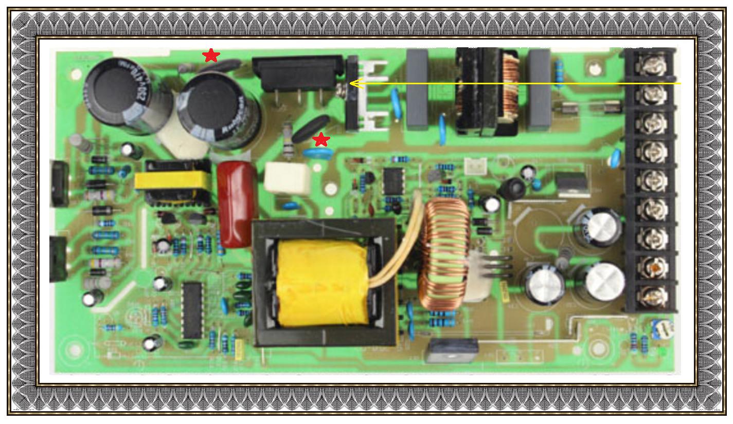

I have a S-360-12 power supply unit that I got brand new on eBay for a nifty $20. Unfortunately it suddenly stopped working today. I was nearby when I heard a gently but clear "pop" and the LED lights went out.
Upon cracking the unit open I found a circular component (see attached photo) boobing around loose inside and a fairly obvious location on the PCB (ever so slightly and barely visibly browned but with solder looking like it had melted) where it came from. As the component was nearly cracked in half the only marking visible were "TC" and a "5" on the line below. Initially I though it was a large high voltage ceramic capacitor. However upon examining a similar lower wattage LED strip power supply unit (still in working order) I found a slightly smaller component labeled "NTC 5D-11" located in the same general area on the PCB next to AC input line.
From half an hour of Web search I am almost confident the blown up part in my S-360-12 LED power supply is a thermistor. But unfortunately I can neither confirm with 100% it is, nor can I know for sure the marking it had. I suspect it was a "5D-15". Can anyone help confirm if (a) it was indeed a thermistor that blew up and (b) that it is a 5D-15?
I am looking for some nomenclature / lists of thermistors to see how they are labeled and organized to understand what the "5D" and "15" stand for? Should I look for a "better" replacement? Also where can I get one in a timely manner? (Usually I get parts from China via eBay, but I tend to plan my projects and needs weeks in advance to allow for shipping times. Local RadioShack is a joke. I live in the nation's capital.)
Also any ideas why would it blow up like this? I have been running a constant 12A load for 16 hour a day for about 5 weeks since I got this power supply. It is rated at 30A so I am certainly not even at 50% of it's power capability.
Thanks for reading and any help will be very much appreciated. The LEDs are part of a living ecosystem so I am a bit pinched with no backup readily available.

it could be a negative temperature coefficient resistor.
these are designed to have a relatively high resistance when cold, with that resistance falling as they heat up. They are sometimes used to limit inrush currents.
it is possible that the one you had was poorly chosen or faulty.

Sir Discoveryellow . . . . . . .
On the unit, see the YELLOW incoming line with your AC line input until it gets to the arrow tip with your AC to DC rectifier and then that is the point where those thermistors come into play.
That DC is to be sent to the left to those two large black UNCHARGED capacitors.
Their required high capacitive values would present such a great loading on that supply that is almost like looking into a short circuit .
The series thermistor is presenting an initial 5 ohms current limiting resistance which will isolate and let the caps initially receive a metered charge.
But simultaneously, their resistance is declining in value and letting the capacitors fully charge up and yet have a minor effect by their being in circuit.
You are correct on your lookup as being the 5D as a 5 ohm cold unit and the second numeral on most manufacturers is relevant to the casing size
Which you are seeing as the 11 versus 15 , you might see how close they come to 11mm or 15 mm measurements if that is being their referencing manner ..
If this was my problem to solve I would install a 60 watt incandescant lamp with interconnect wiring to initially replace the bad thermistor .
Then if you power up and get an initial glow and dimming the unit will probably then justify the thermistors replacement. (Know whut . . . .Spel Chek dussent knows hows to spels "thermistor")
HOWEVER if the lamp GLOWS . . . . you have bad parts that caused that thermistor to BLOW, however I would have expected that far top right glass AC line fuse, to have blown also.
Check it all out . . . . .
Wanna see your pick-choor ?
73's de Edd

The cracked thermistor measured just under 15mm! (See image attached.) So 5D-15 it is. Should I look for the next step up larger just to prevent the blow up again? Also, what is "5D" part stands for?
Thanks for the "pick-choor" illustration, mine looks almost identical (Image attached). I put on an in-line wall receptacle and plugged in my last available 60w incandescent lamp. (Also see attached image).
The lamp gently flashed and went off instantly. Hardly any glow. I repeatedly plugged and unplugged the power supply unit just to ensure the lamp goes of every time. All works. How did you know it would work out this way!?
Next I hooked up my LED load. The first couple of amps worked fine and made the incandescent lamp (in-line of thermistor) to start glowing constantly. However the next 7A of load made DC voltage drop so significantly the blue and white LEDs were off, and red ones were very dim. The incadecent lamp was almost full brightness. I ended up hooking up the final few amps of load to the tune of my original 12A and wiring the receptacle directly. Do you think this will work for a few weeks while I get replacement thermistors from China?
I also went to local RadioShack but alas no thermistors of any kind. Any ideas where I could get one faster than mail from China?
Yes, it is similar with some variations being the PTC in your one is right at the start in the AC line rather than in the DC lines as in the pic Edd posted
This makes a difference in what the device is, its purpose and voltage ratings.
In this case, its main purpose is to try and protect the PSU from large voltage spikes coming in on the power line
Can you please show an underside pic of the AC input area, I would like to confirm if that PTC goes between L and N or L and earth

Sir Discoveryellow. . . . . . .
Good job !
Looks like the evaluative testing that you performed , gave the unit a shakedown and confirms that the whole unit was apparently not damaged at all.
That 60 w lamp limits the power out, only by using 100 or 150 watt lamps would you get more PS power output.
