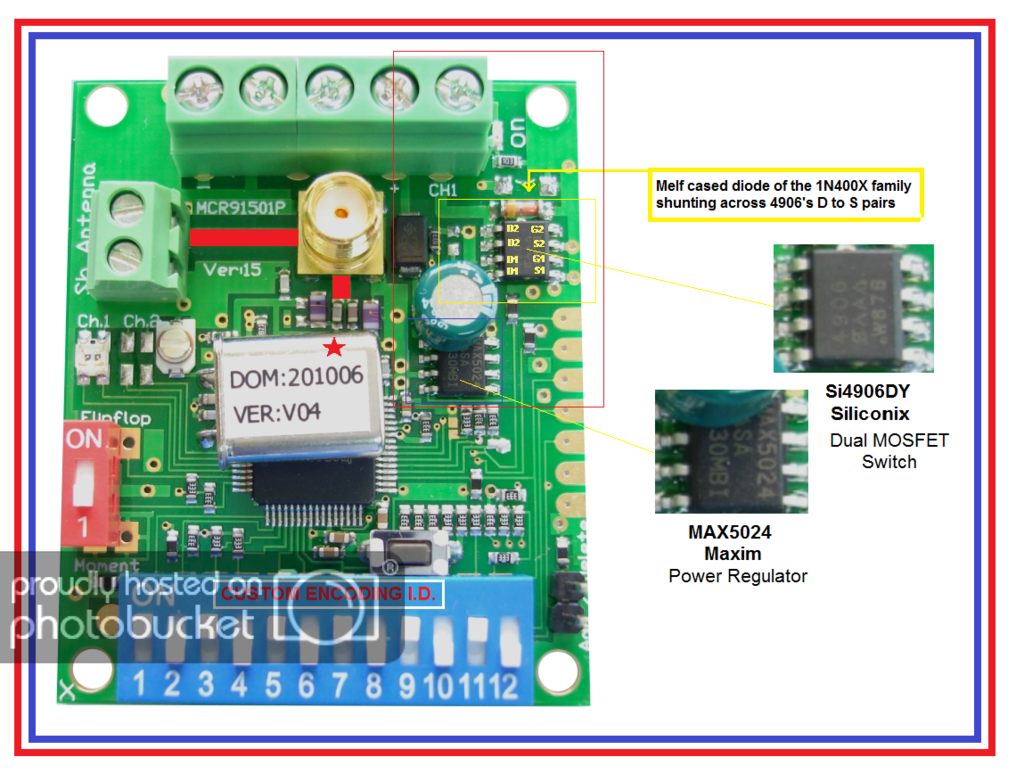

Just out of interest, can you tell us what the labelling is on the part I've circled below:-
There are a few confusing details on the datasheet - they say MOSFET output, then say open-collector, which refers to a transistor and not a MOSFET, then elsewhere they say "Relay output on the receiver can function in either momentary or latching mode."
They don't seem to be able to make up their mind if it's a transistor, a MOSFET or a relay.

Aug 21, 2015
3,730
Aug 21, 2015
3,730
Sirs:
(As it was " channeled " down to me by Paul Harvey . . . . . . good day.)
That looks like quite a pricey item to buy . . .unless it was "gifted " to you . .to be using it for just a simple
RF remoted aspect of a mere whiz-bang function of activating a motor.
My marked up photo . . . . . exhibit 1 tells all:
This lets you readily see two principal IC semiconductors in the FINE RED LINED area
Old Steve . . . . . . . sez
Just out of interest, can you tell us what the labeling is on the part I've circled below:-
The FINE YELLOW LINED area has the Siliconix Si 4906DY dual mosfet, used for system switching duty.
Alec_t . . . . . . sez
In that case I'm puzzled as to why you found only 3V between the V+ and output terminals when the receiver was activated.
Old Steve . . . . . . sez
Like Alec, I'm puzzled as to why there's only 3V between +V and output when it's on. If your 9V battery is connected
between +V and ground, then when it turns on you should be seeing virtually the full 9V between +V and the output terminal,
with an open-collector output. (Actually open-drain, if it's really a MOSFET.)
Note:
The FINE BLUE LINED area is the regulator area
That area is fed by the Maxim MAX5024 power supply chip which has an option of 3.3 or 5V output.
Aside:
I am seeing the RED buss for the long wire "aerial" to the left or its optional SMA hard connector for accepting a whip.
About all I am not seeing is there being a little SMT bipolar xstr, in just about the lower hidden area that the RED star is
marking on the u/p xtal.
With it doing yeoman duty in being a sensitive superregenerative receiver for the system.
Sooooooooooooo . . . . . with a 300 ohm pull up resistor/load that should be providing adequate drive for whatever SEPARATE ancillary power switching device is to be utilized for the motor.
Of course, instead of having a pull up resistor, that could also be fulfilled with a like load loop as being provided by a micro reed relay, an optical isolator,etc .
Thasssssit . . . . . .
73's de Edd
Yes, but if it's an open-drain output, the drain will be pulled to 0V when the 3.3V / 5V is applied to it's gate, so measuring between the drain, (output), and the +9V supply terminal should result in a reading of ~9V.
I thought that was a MOSFET package in the fine yellow-lined area. That was why I asked for the numbering.

73's de Edd, you say:-
"That area is fed by the Maxim MAX5024 power supply chip which has an option of 3.3 or 5V output."
Besides what I said about the open-drain output, that 3.3V or 5V can't be used to switch the SI4906DY dual MOSFET, either - it requires 16V to switch effectively. They are not 'logic-level' MOSFETs.
The datasheet:-
http://datasheetz.com/data/Discrete Semiconductor Products/MOSFETs - Arrays/SI4906DY-T1-E3CT-datasheetz.html
The 16V is max gate voltage. Threshold is .8 - 2.2V Easily switch several amps at 5V. Rds on .05Ω at 4.5V (each). Looks like they are wired in parallel Given that the min supply voltage min is 7V I think the output is 5v
Old Steve
Jul 23, 2015
734
Jul 23, 2015
734
Oops, you're right. I accidentally looked at the wrong figure, instead of the gate threshold voltage. I thought it seemed high for a threshold voltage, usually about 10V with a standard MOSFET. It is logic-level. Makes more sense now. (Dunno how I managed that. :rolleyes: )
Still, what I said about the open-drain is true.
