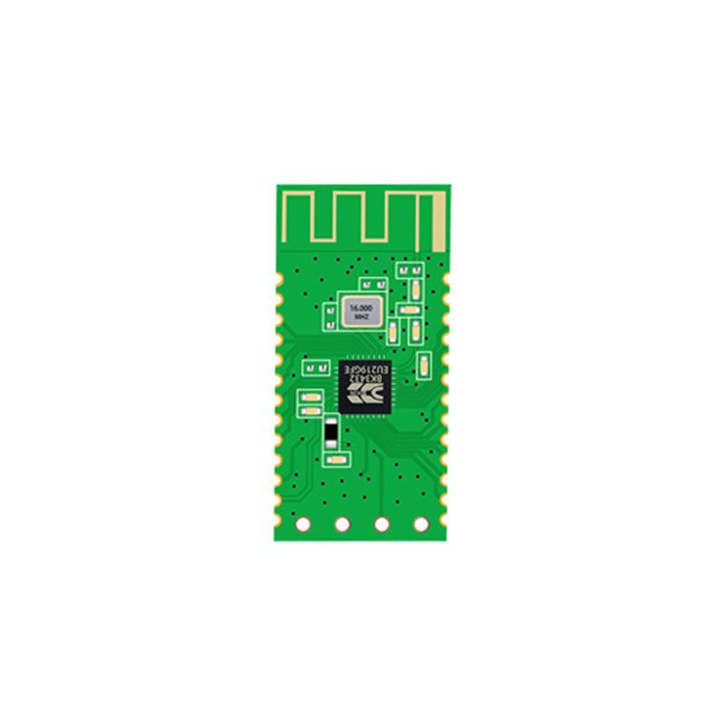

The TS-M1032D is a compact low-power BLE (Bluetooth Low Energy) Bluetooth module featuring a Bluetooth 5.0 chip and support for the BLE 4.2 protocol. It supports both BLE and SPP (Serial Port Profile) dual-mode protocols and is compatible with AT commands, allowing users to modify parameters such as serial port baud rates and device names using the provided AT instructions. Additionally, the module's I/O ports can be directly controlled via an app by sending data, offering flexible and straightforward operation. This module is praised for its excellent stability, ultra-low cost, minimal power consumption, and high reception sensitivity, making it adaptable to a variety of customer development projects.
Model No.: TS-M1032D
Bluetooth Version: BLE 4.2+SPP 3.0
Frequency Band: 2.402GHz-2.480GHz ISM band
TX Power: -20dBm~+4dBm
Receive Sensitivity: -96dBm
Air Rate: 250Kbps/1Mbps/2Mbps
Antenna: PCB Onboard
Advise Range: 80m
Memory: 160KB FLASH+20KB RAM
Pin/GPIO: 30/22
Power Supply: 1.8~3.6V
Operating Temperature: -40℃~+85℃
Peripheral Interface: UART/SPI/I2C/ADC
Serial Transparent Transmission Rate: BLE 4KB/s, SPP 16KB/s
