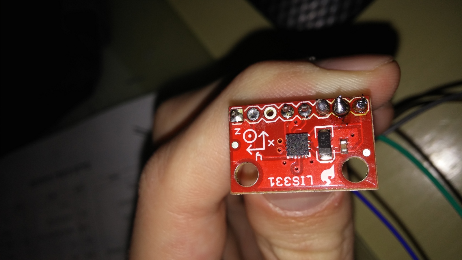

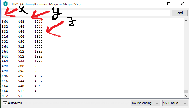

I understand how the code works but I honestly have no ideas what the values/output represents....
I read the Datasheet (https://www.sparkfun.com/datasheets/Sensors/Accelerometer/LIS331HH.pdf), section 2.5.1 about sensitivity - I tried to understand what the values represent but I just didn't understand it . what is "Gain"?
okay so I tried measuring the "sensitivity" (I still have no idea what it means). I pointed the Z axis straight down:
It shows -6000 (approximately) when I point the Z axis straight down......
This is the axis indicator:
This is how I pointed it:
*the picture is rotated but the Z axis points downwords
so it means that 6000 = 1g?
It doesn't sound right.....

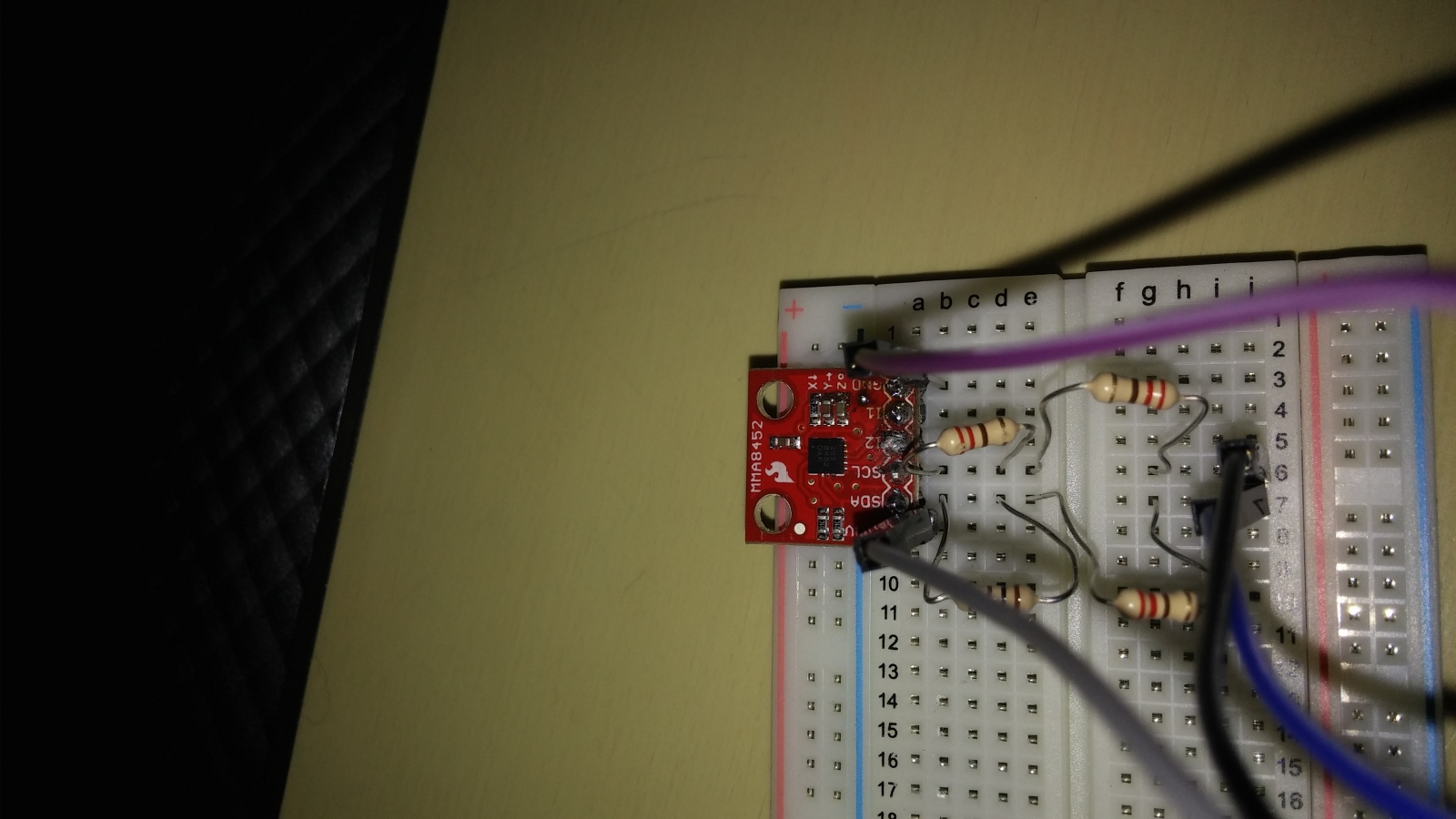

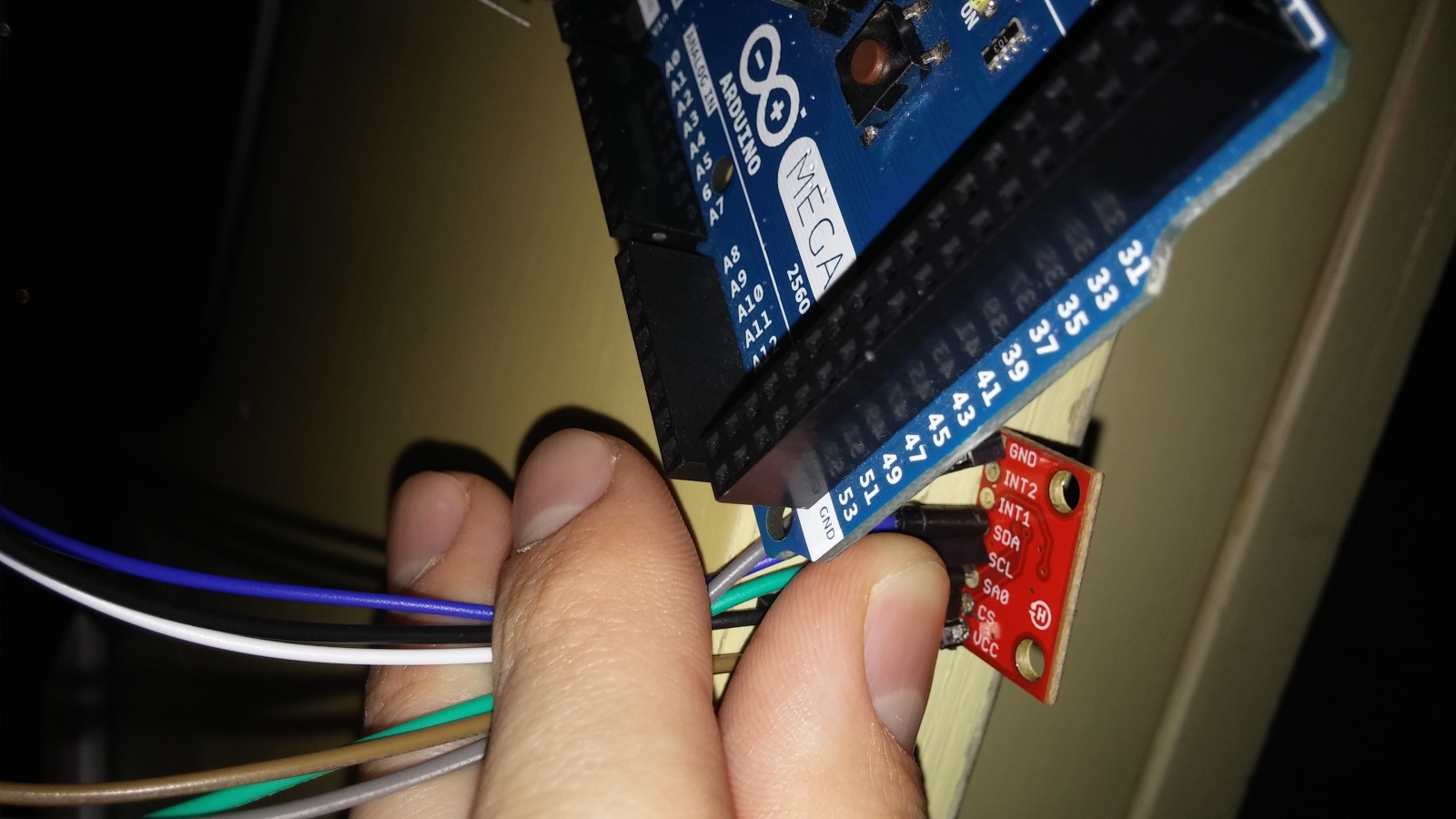

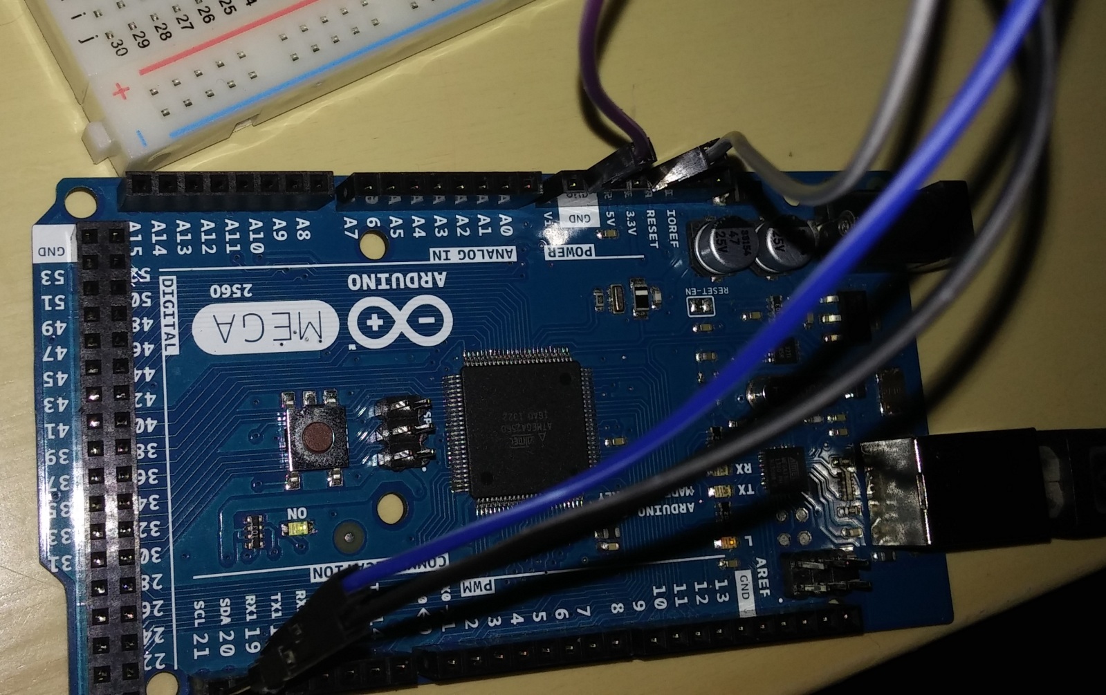

And it just showed nothing :
This is how I hooked it up:
*If you are wondering - I used two pairs of resistors (220 & 100 Ω each) because I didn't have 330 Ω resistors.
Am I doing something wrong? because I am pretty hopeless......
OK you need to understand the use of the accelerometer, as per the datasheet ......
any deviation from this will result in oddball results .... this is correct orientation of the chip
ie., you cannot turn it upside down and expect correct output results

With the device level and the top of the device pointing up. only the Z axis will be responsive and give you 1g. If you turn it upside down you get -1g. The x and Y axis are not responsive so will output 0g. Nothings perfect so there is always some offsetting that needs to be done, normally in software.

You need to read section 5.2. It explains the resolution for 8 and 12 bit opperation. This should help.
