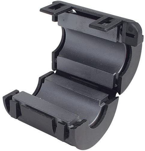

Rohit1203
Sep 14, 2020
7
Sep 14, 2020
7
You could try a large ferrite bead on the cable.
Do you mean ferrite core shown in the below image on the IO cables?
