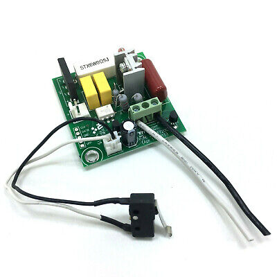

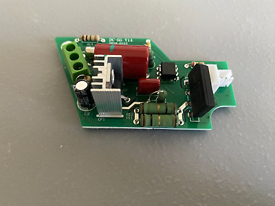

12 ----- ? So called Electronic card ? (Is this REALLY being a/your units BRUSH Control Board . . . I'll just bet 'cha, that it might be ! )
INFO ON AVAILABLE HOOVER CONTROL BOARDS USED in the past. . . . . and possibly being one that is now used on your unit.
HOOVER BRUSH CONTROL BOARD . . . . .
ANOTHER HOOVER BRUSH CONTROL BOARD . . . . .
The somewhat limited power handling capability of the micro switch will be used to provide gate drive switching to the power triac on the circuit board to then switch AC power 120VAC or 220VAC (Where you is ? ) all being at multi THOUSANDS of milliamperes of current to be able to drive that power hungry motors (especially on LOOOONG shag carpet) roller beater brush . . . so that it can keep up the beat.
That is, until you roll forward and the micro switch lever tip detects that movement and shuts off motor power.
That's assuredly using some mechano hocus pocus to interface the switch lever tip to interpret the direction of travel of the unit.
Doesn't this spiel sound logical as being your root problem.

Just an update ordered a new sensor switch off eBay, did some testing with my multi meter and I think it's that that's gone.
Design wise, one would expect a normally off position until the little nub is pushed in . . . . since you mention no lever being on your selected replacement . . . . . to complete an on/closed switch circuit Then the brush controller board does the brute force power switching.
With the unit plugged in and turned on side, just shorting across the microswitch wires terminals should power up the brush motor if the control board is good and if it has no blown pigtail fuse.
Also, how about enlightening us all, on what you found was being the mechanical- voo doo involved in converting direction of movement to that microswitch ?
