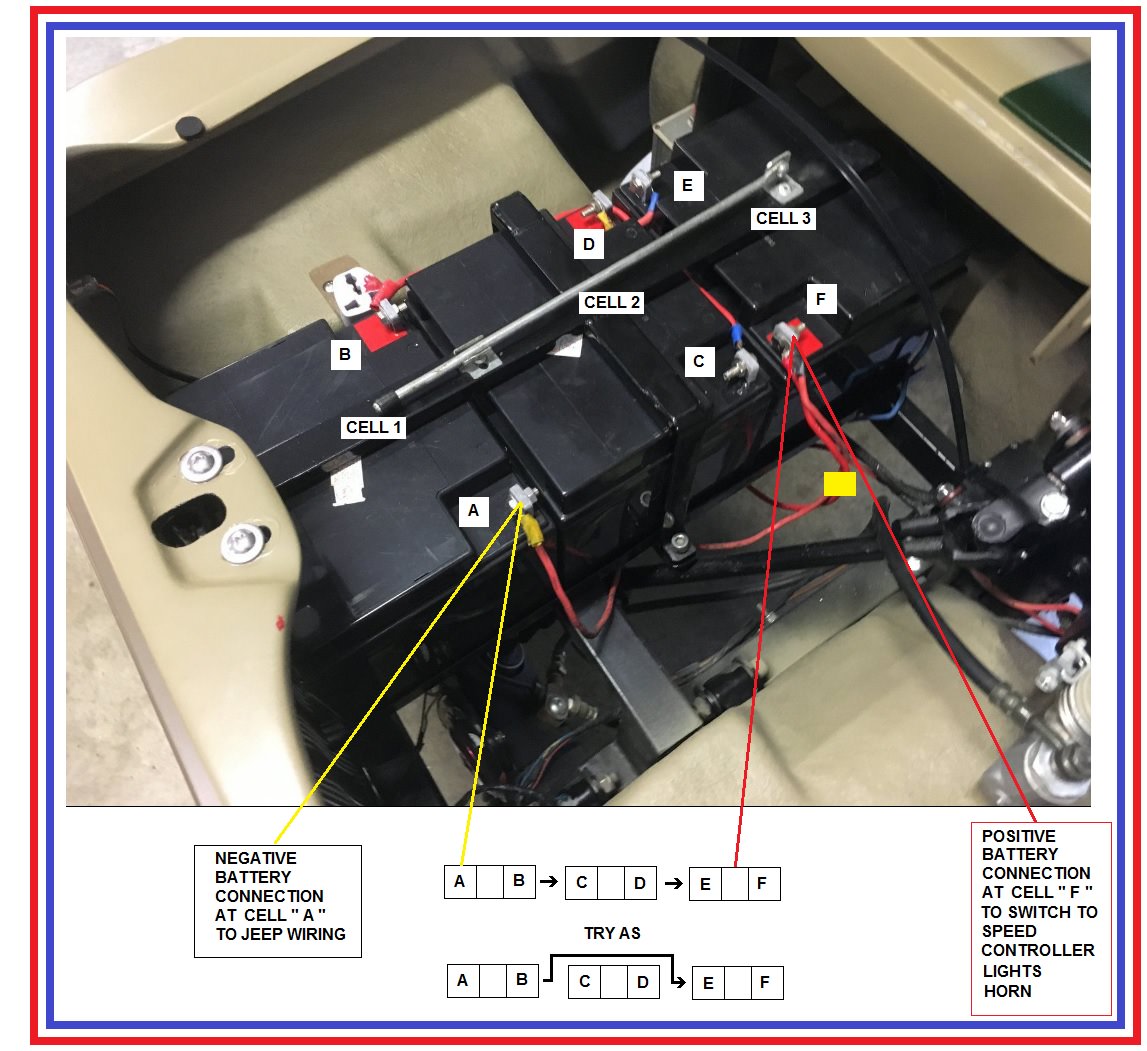

Sir surreyman . . . . .
BOY ! . . . . . .that little thing is as neat as they come.
If I am guessing correctly on some of the the partially hidden wiring runs.
If you tried one less cell out of circuit . . . likely it is as the illustration below now shows.
With you pulling the connection at C and pulling it back to E area and then disconnecting the connection currently at E and place on the former C connector . . . as the bottom illustration shows.
PLUS . . .my . . . . interconnect wiring links was positively confirmed with your last new photo.
As far as torque, and the wire gauge seen being used , this thing must really be geared down from drive motor to wheel drive.
My recommendation agrees with another's, 1000%, and that would be the mechanical implementation of the physical limitation of the downward travel limit of the accelerator pedal.
PHOTO MARK-UP . . . . .
73's de Edd

I think he removed link B-C and refitted cable A to C which would be correct.
Perhaps the controller just does not like low voltage.
Wondering what is the extra cable from terminal "F"...??
Hidden wiring does not help.
B currently joins with C so i disconnected both ends. I then moved A to C - My logic was i had removed cell 1 from the chain. The jeep did not work- there are actually 4 cells as the final one is located in the rear. i have been told that i can put another varable resistor after the current one thats on the end of the throttle pedal (its a black plastic thing where the two halfs slide in and out of each other when the pedal is pressed)

I think it's about time you supplied a bit of a sketch of the layout and what is wired to what and how.
Front headlights + other lights . . and possibly it has a horn.
