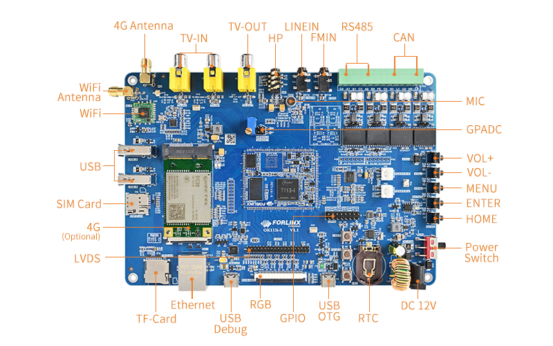

The FET113i-S SoM is developed and designed based on Allwinner T113-i industry processor, with a main frequency of 1.2GHz. It is equipped with multi-core and multi-architecture: integrated dual-core Cortex-A7,CPU64-bit XuanTie C906RISC-VCPU and DSP, which not only provides efficient computing power, but also has rich multimedia functions and complete interface resources; stamp hole design makes product more durable, and the development board draws out as much processor core resources as possible, which is a cost-effective choice for key areas such as industry, power, transportation and so on!
This article will briefly share the process of adapting Forlinx T113i-S development board to LVDS screen display.
Development platform: Forlinx T113i-S development board
To modify the T113i screen, you need to modify the kernel and uboot respectively. Take the LVDS 1024 * 600 screen as an example.
