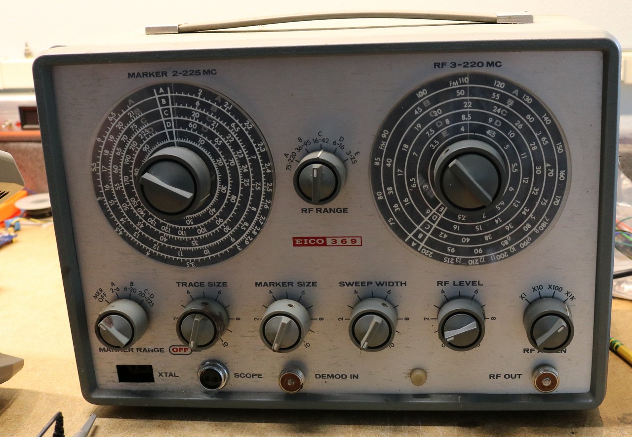

Years ago I bought an RF sweep generator to align the IFs in television sets. You inject the swept RF into the first stage and look at either the demodulated output or the RF output using an RF probe on an oscilloscope whose horizontal sweep is synchronized to the sweep generator sweep. Below is a picture of the EICO sweep generator I used for TV sets. Obsolete for the TV technology used today.

Hop,
What are those strange "RF connectors " ?
never seen them before.
That EICO can still be used for alignment of "Hi-FI" receivers in it's "A BAND"
used to be very common on budget gear of the early years, had more than one bit of gear with that style
not sure what they were called ?

Sir Kennynva. . . . . . . . . . . . .
Messrs . . . Hop, Davenn et Dorke . . . . .
BEHOLD . . .ye olde tyme . . . . . .
Amphenol 75 series microphone connectors:
