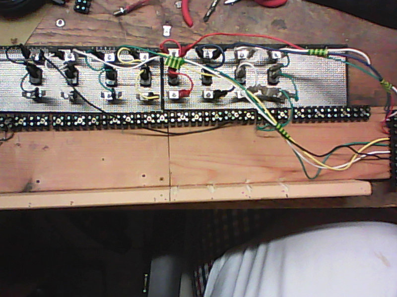

Here a view to the same panel from below. It shows the cables that come from the connector row on the right edge of the picture. Below the panel you see the screwable connectors, 5 for each tension, so that I as the user have the choice to select if I want to use the receptacle connector on the front side of the panel or connect a cable to one of the related screwable connectors.

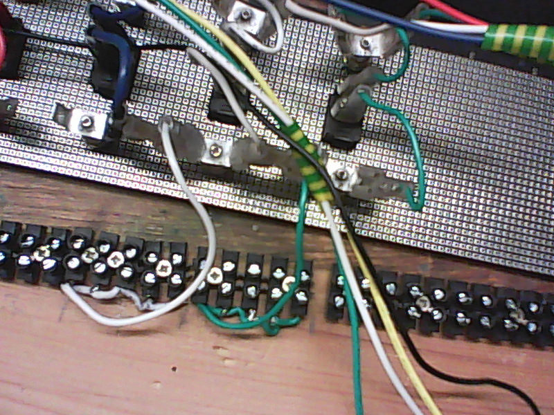

here you see why I came to the conclusion a short circuit protection is necessary! Let's take a detailed look at the white cable connecting the power to the corresponding screwable connectors. The risk that a short circuit could happen any time in the future does not only result from short circuits taking place further down the line, but also i.e. the white and the green cable are so close to each other that a short is possible! Of course I will install not conducting physical barriers to prevent this from happening, but I also want to place electronic fused just before the connectors row on the right edge show in a picture above.

I want to use electronic self resetting fuses, PTC's, that cut the line if a sudden rise of the current flowing to the increases. How can I find the proper PTC fuses?

1. PPTCs are not very fast, they are as fast as slow-blow fuses.
2. You can get them from TE ,little-fuse, and others.
3. If you use a banana biding post like this one you can eliminate the need for the terminal blocks.
4. Your build should be very well insulated and use proper thickness wires.

At the currents you are anticipating, along with the probability of accidental shorts while experimenting, I would recommend using a panel-mounted reset-able thermal-mechanical circuit breaker such as found on this Google page result.
PTCs are good for non-frequent "trips" but don't provide any indication that something has gone wrong except for loss of power. And after they cool off they come on again, which may not be immediately desirable. Years ago (in the previous century) I built a power supply using a through-hole panel-mounted aircraft circuit breaker. This was the pop-out variety rather than a toggle switch. It not only provided positive indication when tripped, but could also be used as a disconnect switch by pulling on the pop-out indicator.
Unfortunately, back then they were very expensive so I could only afford to use one, placed in the mains circuit. Today, they are much less expensive and well worth it for the convenience they provide in a bench power supply. They are also available in a rocker actuator style that could directly replace your existing power switches.
