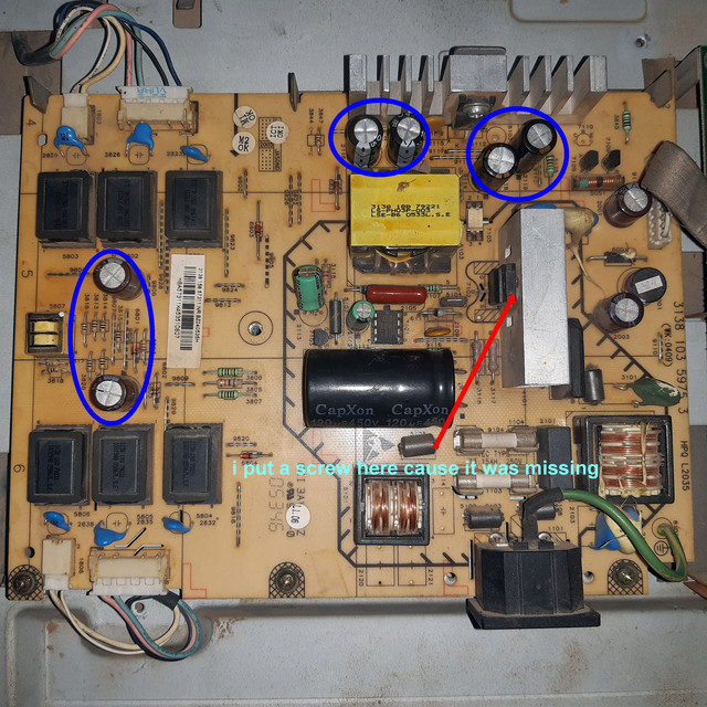

I would be checking the ESR of the capacitors in the power supply. I've taken a look at your photos and none of the capacitors look stereotypically faulty.
i already changed two bad capacitors in the power supply board but the problem still exist

Show me which capacitors you have changed.

I probably would have changed the two on the right hand side if I was already changing the others.
And I agree with screwing that device to the heatsink. I assume there's nothing connected to the other side of that heatsink?
no there's nothing.

Looks like that varistor over on the right hand side has either been physically damaged or errupted under some fault.(3101)
Sure looks old......:)
Switcher IC can sometimes go open but it doesn't seem to have had much heat around it.
Wonder why the screw was missing..?? maybe the mosfet has popped, did you test it at all..?
A few caps in that area that could have gone belly-up.
Did you test any of those..?

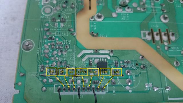

where should i measure it?
The ribbon cable leading away from the right side of the board contains the various voltage rails.
You're likely to find that one side of all the capacitors you changed ( and the other two I pointed out) have one side common. That will be your ground rail (measure voltages with respect to that).
The other side of most of the capacitors will be directly connected to the other pins on ribbon cable.
You should be expecting voltages like 3.3V, 5V, 12V. Tell us what you read and we can give you an idea if they sound right.

Those are the measurements, the left one is negative and the one with black dash is negative

I'm not sure which ones are negative (or do you mean that the three with the black pen markings are all connected to ground?). Can I assume that you made these measurements with the main circuit disconnected from the power supply?
It looks like a regulated 3.3v output with the other floating a little high due to the lack of a load.
The three reading 0V appear to be very low current connections (note the narrow traces) so these may be signal inputs (or outputs) to the power supply, possibly to indicate when to turn the back light on, or to indicate a power good status.
Can you measure these tails on your AC range? Also preferably with the load connected.

What I mean is, were the two boards disconnected from each other when you made the measurements?

Please repeat the measurements with the boards connected. Please remember to take measurements on the AC range as well as DC.
