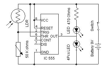

I can try that, what do you think of this one?

If P3 out is high there will be no current limit for the lower LED - POP. Add another 470Ω resistor.

Or move the one resistor to go between pin 3 and the junction of the two LEDs.
I think not, if there is no resistor in the LED chain, then the current from the supply will be unlimited.
